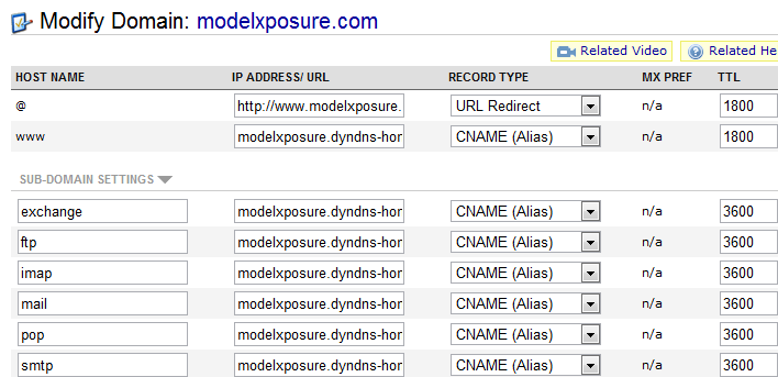

External Domain @ DNS @NameCheap.com
These resolve to my DynDNS link that always points to my home IP.

derp. nevermind, My phone was connecting to the guest lan at my work, which has no direct access to my house. Switched off wifi and it connected. I still would like to try and move the domain name so that i don't have domain.local and domain.com :(
