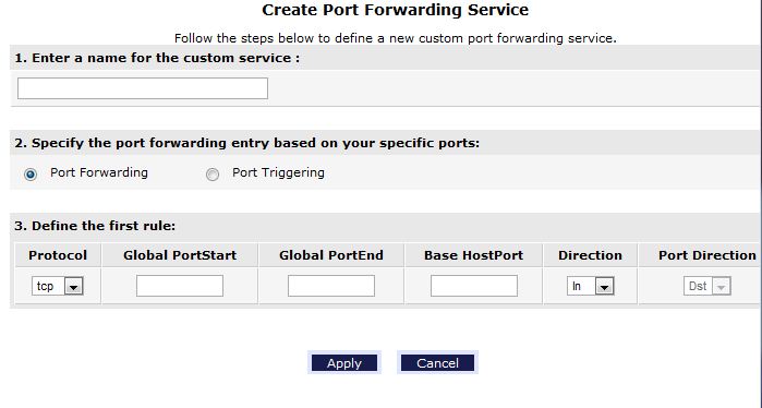

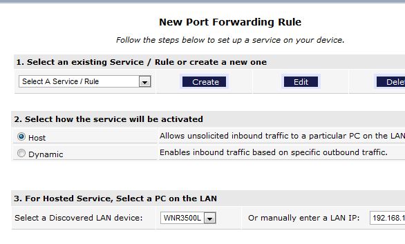

freak180 Posted July 2, 2012 Author Share Posted July 2, 2012 Care to help me step by step? Like in the screen shots what do I fill in? I know 3389 is the port for remote desktop and all my attempts seem to fail. I even tried port forward on both routers and still no luck :\ Link to comment Share on other sites More sharing options...
sc302 Veteran Posted July 2, 2012 Veteran Share Posted July 2, 2012 3389 should be in all 3 port fields in the first screen shot. in the second screen shot you should select the pc you want to connect to. I would disable any and all software firewalls, including windows firewall and any av suite based firewall, for testing purposes. make sure you can connect within the network prior to trying external. leaving 3389 open isn't recommended due to it being compromised a few months back (there is a fix for now, but how long until someone finds a way around it). I would use a service like teamviewer or logmein, which are free btw, to remote into your computer(s). if you have another router between the computer and the verizon piece that you have screen shotted above, all of this is a moot point as you are in a double nat situation which rarely, if ever, works properly. Link to comment Share on other sites More sharing options...
