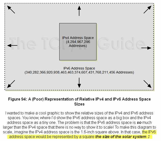

+BudMan MVC Posted July 23, 2012 MVC Share Posted July 23, 2012 Trillions? You need to check the math again ;) A /64, which is what is planned to give to each lan or vlan - so pretty much your ISP will give each user a /64 - your talking about 2^64 or 18,446,744,073,709,551,616 addresses for your home.. the total address space for ipv6 is 2^128 or 3.4028236692093846346337460743177e+38 Dude its HUGE amount of space - no there is no plans for NAT to be needed. Here read this for some examples of how big the address space is http://www.tcpipguid...ressSpace-2.htm The earth is about 4.5 billion years old. If we had been assigning IPv6 addresses at a rate of 1 billion per second since the earth was formed, we would have by now used up less than one trillionth of the address space. The earth's surface area is about 510 trillion square meters. If a typical computer has a footprint of about a tenth of a square meter, we would have to stack computers 10 billion high blanketing the entire surface of the earth to use up that same trillionth of the address space. Here are a couple more analogies of the size difference in ipv4 vs ipv6 So, ball park, if all the IPv4 space would fit in an iPod, then all the IPv6 space is the size of the entire Earth. "if the earth were made entirely out of 1 cubic millimetre grains of sand, then you could give a unique [iPv6] address to each grain in 300 million planets the size of the earth" Link to comment Share on other sites More sharing options...

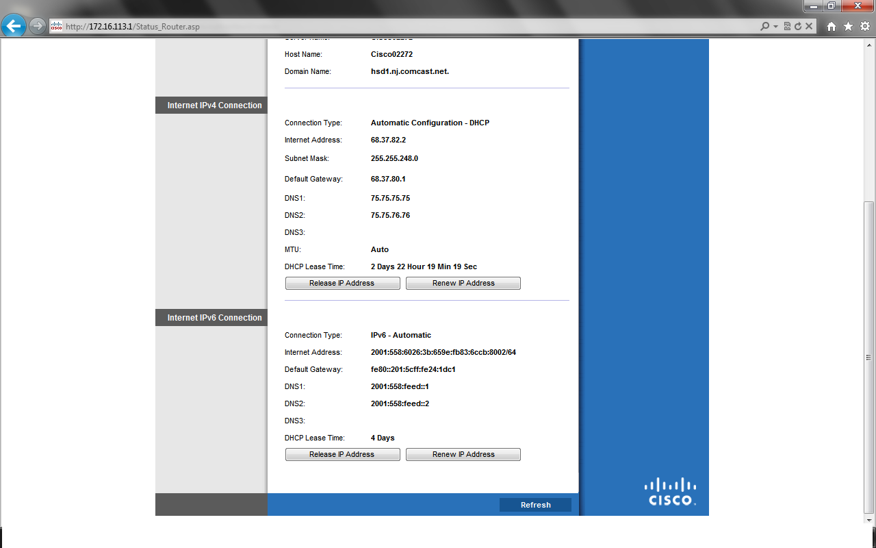

Roger H. Veteran Posted July 24, 2012 Veteran Share Posted July 24, 2012 Tomato Toastman builds supported DHCPv6-PD also (well in that i see it as an option, no native IPv6 here - Cablevision). Here's what an IPv6 address looks like and the way the router is shown as well: (Took those from Broadband Reports forums). Anyways, your router would be assigned a block of addresses, as was said a /64 which is more addresses than the ENTIRE IPv4 network currently can carry. So then you can put 4 BILLION devices and more on your network if you so want to. LOL. So from the screenshot, Comcast assigned 2601:000c:1b80:/64 to that user so then they can use any combination of that after for other devices on the network. The Fe80:/8 addresses are similar to the 192.168.x address we have now. Those are all internal/local. Link to comment Share on other sites More sharing options...
