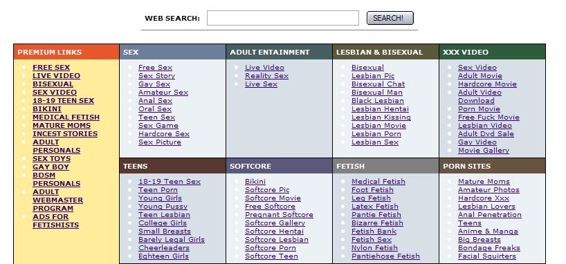

tiger2k Posted October 20, 2003 Share Posted October 20, 2003 everytime i type an address wrong the page that normally appears, "page could not be found" got replaced with some porn search page :angry: does anyone know where i could chagne this back, i did a adaware scan and an antivirus scan and i don't get anything, i also checked the shdoclc.dll to see if the 404 page got replaced and it didn't. does anyone got any idea how i can get this back to normal, maybe some regestry change, or something Link to comment Share on other sites More sharing options...

tiger2k Posted October 20, 2003 Author Share Posted October 20, 2003 in the address bar it just shows whatever i typed before, if i right click the page it shows what i typed for the address in the properties dialog, so i guess i have to show u a picture of what it is and i did a spyware search and adaware comes up with nothing :s Link to comment Share on other sites More sharing options...
IlliniPi Posted October 20, 2003 Share Posted October 20, 2003 I think somene has a nylon fetish. :p Link to comment Share on other sites More sharing options...

blackice912 Veteran Posted October 20, 2003 Veteran Share Posted October 20, 2003 Something like this happened to me before - it gave me "free daily lesbian pictures" Ad-aware wouldn't detect it, but I found it in "Internet Options/Settings/View Objects" Might be something in there. Link to comment Share on other sites More sharing options...

caye Posted October 20, 2003 Share Posted October 20, 2003 ok, try this. open your registry editor, edit->find, input "search page" in the "find what" box, see if there is the address that is same as the address it displayed when you typed the wrong page address. if yes, delete it. and don't fail to "find next" after you delete the first one you find. Link to comment Share on other sites More sharing options...

OPaul Posted October 21, 2003 Share Posted October 21, 2003 The setting for that page is in the registry, seach the URL and replace it with what you want. The default for the keys that control this are as follows; [HKEY_CURRENT_USER\Software\Microsoft\Internet Explorer\Main] "Search Page"="http://www.microsoft.com/isapi/redir.dll?prd=ie&ar=iesearch" [HKEY_CURRENT_USER\Software\Microsoft\Internet Explorer\SearchUrl] "provider"="" [HKEY_LOCAL_MACHINE\SOFTWARE\Microsoft\Internet Explorer\Search] "CustomizeSearch"="http://ie.search.msn.com/{SUB_RFC1766}/srchasst/srchcust.htm" "SearchAssistant"="http://ie.search.msn.com/{SUB_RFC1766}/srchasst/srchasst.htm" Link to comment Share on other sites More sharing options...
Mysterio Posted October 22, 2003 Share Posted October 22, 2003 also...there's likely a executable firing up through the registry run key: here: HKEY_LOCAL_MACHINE\SOFTWARE\Microsoft\Windows\CurrentVersion\Run that will change the above mentioned settings even if you yourself corrects it...make sure to check that section in the registry for any unknown executable...some trojans go as far as to make the registry change for individual users logging into an NT based system...so even if you log in as the admin and make all these corrections...as soon as a user logs in; that run key for this user fires up the given executable file... you have to find this file and remove it off of your drive.... Link to comment Share on other sites More sharing options...
