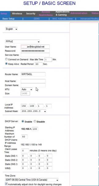

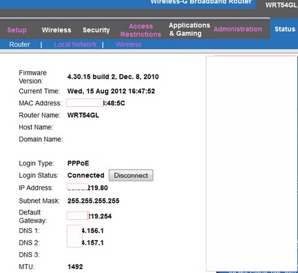

Cheryl_27    4
You're correct - it's a 2Wire 2701 HG-B Gateway, put into bridge mode. The router part wouldn't work w/ VOIP (don't EVEN want to discuss how much time I spent w/ AT&T / 2Wire / VOIP provider Tier 2 techs). Put in bridge mode, got a router - VOIP worked. Can't say exactly how well this modem & router communicate, but 2Wire never fails to reconnect after ANY kind of outage. If there are no POWER outages, never lost WAN connection for > couple min. w/ this "modem" & router. Then reconnects on its own.
Yes, PPPoE. I'll assume what you want by the "WAN config page." Let me know if screens aren't what you want.

+BudMan    2,906
Ok good to hear your in bridge mode - first thing. So you bought a GL, and then you left their nasty crapware firmware on it??
You have a GL -- put some 3rd party on it.. Be it dd-wrt, Tomato, TomatoUSB, openwrt, hyperWRT, etc. etc..
I would really suggest you do that, then if your still having issue we can look into why. But I have a funny feeling that once you put some decent firmware on it your problems will be gone.
