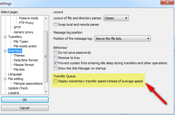

I can't find the setting in filezilla atm, but I remember by default it only displays the average transfer speeds, you have to change a setting to force it to show actual transfer speeds in realtime

+BudMan    2,900
^ I believe this is the setting your talking about

Detection    2,256
That's the one thanks :)

Thanks for the tip about the interface speed displays. I think the server shows real time speeds by default so the problem still exists.
