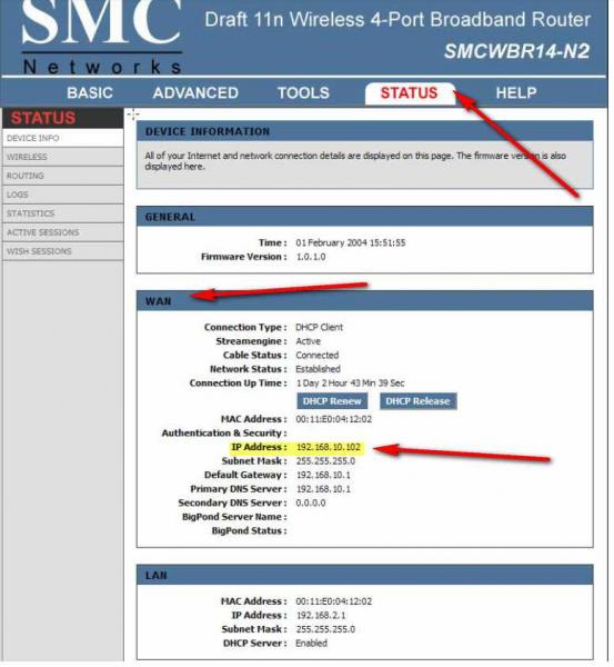

+BudMan MVC Posted August 30, 2012 MVC Share Posted August 30, 2012 So you now have PUBLIC IP on your wbr wan interface? if so then either your ISP is blocking the port? Many isps block such things as 80 and 25 for example. If not blocking and you have public on your router, then either your port forward is not working. Some routers don't like UPnP enabled while doing manual port forwards for example. Or you just have it forwarding to the wrong IP of the machine inside, or your inside machine is not listening on the port or has a firewall blocking the port, etc. First step is the verify you have a public IP on the WAN. What port are you wanting to forward? is this port listening on your inside box? Simple to test with netstat -an command on that box, can you connect to your service your trying to forward through your router/firewall to from another machine on your network using the private IP of the machine? Do you have something setup to be in the DMZ of the wbr - you can not have a dmz host and then forward a different port to different machine etc. Atleast many routers are like this. You sure you set up the forward correctly on the WBR, and not some port triggering rule?? I see this quite often as well with users trying to setup port forwards. Also the box your forwarding to is connected to the WBR, you don't have some other nat behind your WBR do you? Link to comment Share on other sites More sharing options...

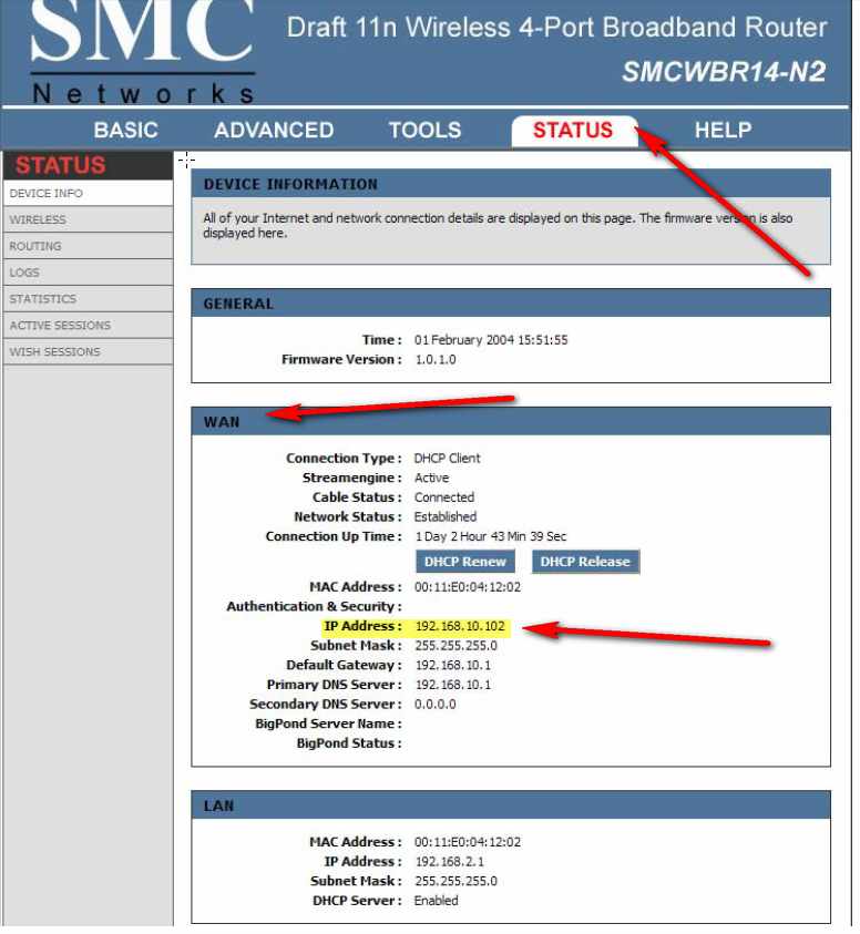

+BudMan MVC Posted August 30, 2012 MVC Share Posted August 30, 2012 DUDE --- WHAT IS THE WAN IP?? If you saying its 192.168.2 then your still behind a nat, and your speedtouch is NOT in bridge mode. is the IP address under your status and WAN show a 10.x.x.x or 192.168.x.x or 172.16-31.x.x then your speedtouch is NOT in bridge mode!! Link to comment Share on other sites More sharing options...
blanked Posted August 30, 2012 Author Share Posted August 30, 2012 Sorry for the confusion IP Address : 192.168.1.64 Link to comment Share on other sites More sharing options...
+BudMan MVC Posted August 30, 2012 MVC Share Posted August 30, 2012 Well thats a PRIVATE IP address now isnt it -- so NO your forwards are NEVER going to work.. Because the NAT device in front of it is not sending the ports to 192.168.1.64, since your WBR never sees the traffic - it kind of hard for it to forward it to your 192.168.2.x box that you want to see this traffic now isn't it! If your ISP told you your speedtouch is in bridge mode -- they are IDIOTS!!! because clearly its NOT! Or your WBR router WAN would be a PUBLIC IP, ie NOT 192.168 or 10.x or 172.16-31 Link to comment Share on other sites More sharing options...
