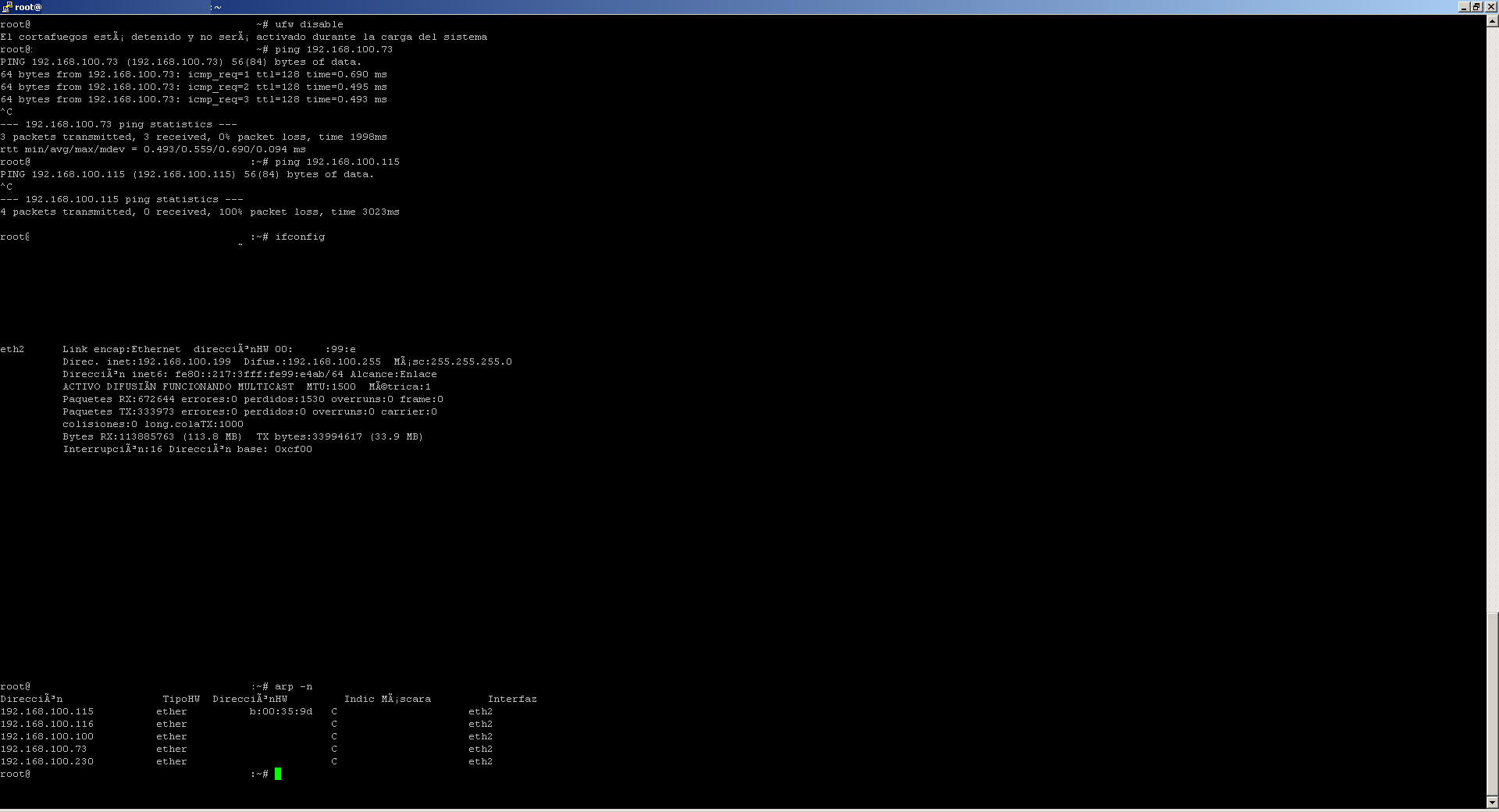

cut Posted September 17, 2012 Author Share Posted September 17, 2012 so it is sending reply to your ping -- do a sniff on the box that sending, its not seeing replies? OK, we are getting somewhere: The machine is not seeing the replies from Linux 1. root@mylocalmachine:~# tcpdump -i eth2 > results tcpdump: verbose output suppressed, use -v or -vv for full protocol decode listening on eth2, link-type EN10MB (Ethernet), capture size 65535 bytes 13 packets captured 78 packets received by filter 35 packets dropped by kernel root@mylocalmachine:~# cat results 16:20:16.308831 IP mylocalmachine.local.ssh > localsite.net.27235: Flags [P.], seq 2762984911:2762985107, ack 2735301118, win 2387, length 196 16:20:16.308882 IP mylocalmachine.local.ssh > localsite.net.27235: Flags [P.], seq 196:248, ack 1, win 2387, length 52 16:20:16.309384 IP localsite.net.27235 > mylocalmachine.local.ssh: Flags [.], ack 196, win 4380, length 0 16:20:16.309672 IP mylocalmachine.local.27450 > 192.168.100.100.domain: 41740+ PTR? 199.100.168.192.in-addr.arpa. (46) 16:20:16.309791 IP localsite.net.27235 > mylocalmachine.local.ssh: Flags [P.], seq 1:85, ack 248, win 4367, length 84 16:20:16.309883 IP localsite.net.27235 > mylocalmachine.local.ssh: Flags [P.], seq 85:137, ack 248, win 4367, length 52 16:20:16.312555 IP 192.168.100.100.domain > mylocalmachine.local.27450: 41740 NXDomain* 0/1/0 (153) 16:20:16.313252 IP mylocalmachine.local.7622 > 192.168.100.100.domain: 56557+ PTR? 100.100.168.192.in-addr.arpa. (46) 16:20:16.316045 IP 192.168.100.100.domain > mylocalmachine.local.7622: 56557 NXDomain* 0/1/0 (153) 16:20:16.360744 IP mylocalmachine.local.ssh > localsite.net.27235: Flags [.], ack 137, win 2387, length 0 16:20:16.377800 IP mylocalmachine.local.ssh > localsite.net.27235: Flags [P.], seq 248:284, ack 137, win 2387, length 36 16:20:16.416444 IP6 fe80::217:3fff:fe99:e4ab.mdns > ff02::fb.mdns: 0 PTR (QM)? 100.100.168.192.in-addr.arpa. (46) 16:20:16.416502 IP mylocalmachine.local.mdns > 224.0.0.251.mdns: 0 PTR (QM)? 100.100.168.192.in-addr.arpa. (46) Also some are getting dropped by the kernel (which could be those) Link to comment Share on other sites More sharing options...

cut Posted September 18, 2012 Author Share Posted September 18, 2012 set your capture to only be icmp, that should rule out the drops being what your looking for in your capture. Couldnt remember the way to filter, sorry. What kind of switch is this? Is it possible its doing any filtering? I don't see any icmp in that capture at all? Dumb simple switch. Nothing about it special. I would also verify your listening on the correct interface - eth2 seems odd to me in your post. The PC has 2 network cards. The first one (eth1) is ****ed up so Im on eth2. Ive also confirmed it with a ifconfig. Ill try this in a second.... Link to comment Share on other sites More sharing options...
cut Posted September 18, 2012 Author Share Posted September 18, 2012 Here you go: Ive checked and rechecked again any and all possible firewall issues (software and hardware) and as you saw in posts before, its disabled. Link to comment Share on other sites More sharing options...

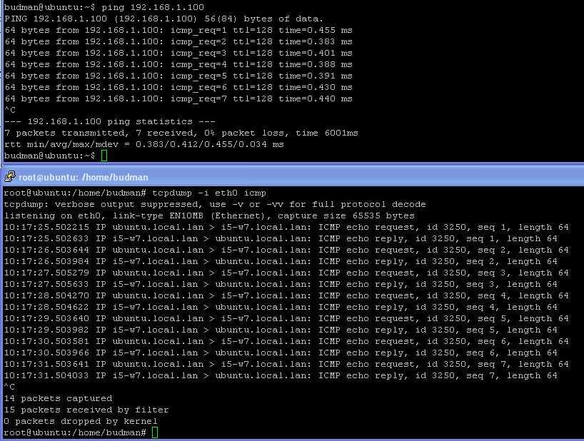

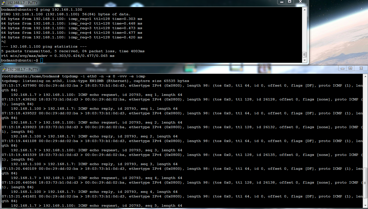

+BudMan MVC Posted September 18, 2012 MVC Share Posted September 18, 2012 What are you showing me there.. You got it showing pings and answers.. And then your capturing on the other side only showing it send. What about the capture on the other side while that ping was going? My example was to just show the command for ping only, etc.. And can I see the settings of the ips? And the macs, and these are what flavor of linux? Can see output of iptables -L example root@ubuntu:/home/budman# iptables -L Chain INPUT (policy ACCEPT) target prot opt source destination sshguard all -- anywhere anywhere Chain FORWARD (policy ACCEPT) target prot opt source destination Chain OUTPUT (policy ACCEPT) target prot opt source destination Chain sshguard (1 references) target prot opt source destination root@ubuntu:/home/budman# ifconfig eth0 Link encap:Ethernet HWaddr 00:0c:29:dd:02:ba inet addr:192.168.1.7 Bcast:192.168.1.255 Mask:255.255.255.0 inet6 addr: fe80::20c:29ff:fedd:2ba/64 Scope:Link inet6 addr: 2001:470:7c:27::777/64 Scope:Global UP BROADCAST RUNNING MULTICAST MTU:1500 Metric:1 RX packets:215356 errors:0 dropped:10 overruns:0 frame:0 TX packets:147978 errors:0 dropped:0 overruns:0 carrier:0 collisions:0 txqueuelen:1000 RX bytes:125120650 (125.1 MB) TX bytes:110565504 (110.5 MB) lo Link encap:Local Loopback inet addr:127.0.0.1 Mask:255.0.0.0 inet6 addr: ::1/128 Scope:Host UP LOOPBACK RUNNING MTU:16436 Metric:1 RX packets:6 errors:0 dropped:0 overruns:0 frame:0 TX packets:6 errors:0 dropped:0 overruns:0 carrier:0 collisions:0 txqueuelen:0 RX bytes:300 (300.0 B) TX bytes:300 (300.0 B) Have you tried resetting your switch? What is the model number? Link to comment Share on other sites More sharing options...

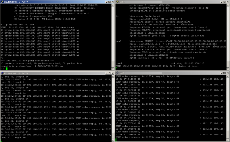

cut Posted September 19, 2012 Author Share Posted September 19, 2012 What are you showing me there.. You got it showing pings and answers.. And then your capturing on the other side only showing it send. What Im showing that it works on one side and on the other side it doesnt work.... And can I see the settings of the ips? And the macs, and these are what flavor of linux? Can see output of iptables -L example root@ubuntu:/home/budman# iptables -L Chain INPUT (policy ACCEPT) target prot opt source destination sshguard all -- anywhere anywhere Chain FORWARD (policy ACCEPT) target prot opt source destination Chain OUTPUT (policy ACCEPT) target prot opt source destination Chain sshguard (1 references) target prot opt source destination Im on another thing now so Ill have that in a few days. Latest version of Ubuntu. Have you tried resetting your switch? What is the model number? Yes. The model is a Beckhoff ES2008 Link to comment Share on other sites More sharing options...

+BudMan MVC Posted September 19, 2012 MVC Share Posted September 19, 2012 "What Im showing that it works on one side and on the other side it doesnt work...." But your showing it the wrong way! Need the capture from the box your pinging - want to see getting the pings and sending them back, but your box is not getting them back? Or is it - capture on it as well. Open 3 windows, one showing you sending pings capture on the sender, then in another window show capture on the box your pinging. And lets see full macs and full pings. Like this and provide more info in the capture, example tcpdump -i eth0 -n -s 0 -vvv -e icmp And the output of ifconfig on both boxes.. showing all intefaces, and then output of ethtool on the interfaces your using root@ubuntu:/home/budman# ethtool eth0 Settings for eth0: Supported ports: [ TP ] Supported link modes: 1000baseT/Full 10000baseT/Full Supported pause frame use: No Supports auto-negotiation: No Advertised link modes: Not reported Advertised pause frame use: No Advertised auto-negotiation: No Speed: 10000Mb/s Duplex: Full Port: Twisted Pair PHYAD: 0 Transceiver: internal Auto-negotiation: off MDI-X: Unknown Supports Wake-on: uag Wake-on: d Link detected: yes I am really curious if your actually pinging the correct macs -- which I want to see the output of ifconfig showing the interfaces, and ethtool will show duplex level, etc.. As mentioned as something to look at. ifconfig will also show if errors on your nic, etc. root@ubuntu:/home/budman# ifconfig eth0 Link encap:Ethernet HWaddr 00:0c:29:dd:02:ba inet addr:192.168.1.7 Bcast:192.168.1.255 Mask:255.255.255.0 UP BROADCAST RUNNING MULTICAST MTU:1500 Metric:1 RX packets:215356 errors:0 dropped:10 overruns:0 frame:0 TX packets:147978 errors:0 dropped:0 overruns:0 carrier:0 collisions:0 txqueuelen:1000 RX bytes:125120650 (125.1 MB) TX bytes:110565504 (110.5 MB) Link to comment Share on other sites More sharing options...
