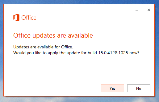

Ok, today I was offered the update that messes up the Jump Lists for me, here's a screenshot, of course I did not accept it, not sure if this will help, try and see if your version of Office is already on that build number, if it is, it means you already got the update at some point or are automatically accepting updates without notifying you.
Hmm. Word 2013 reports the version of Office 2013 is 15.0.4128.1014.
