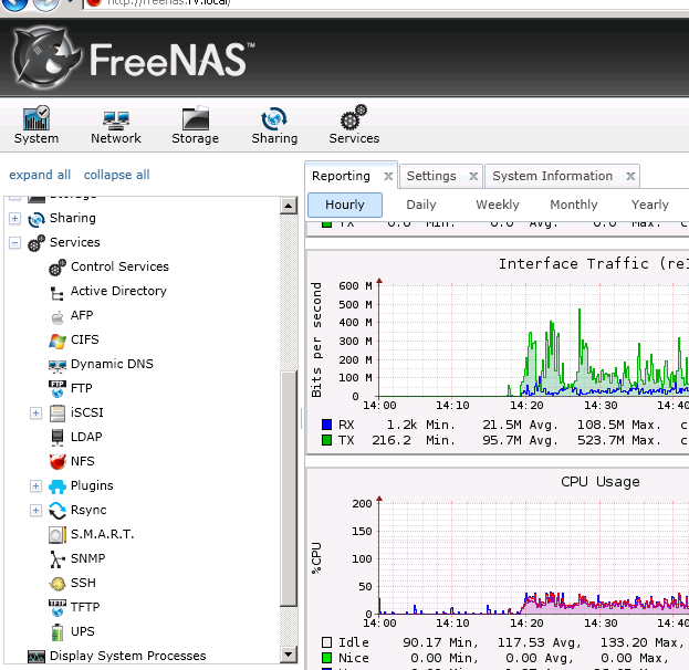

If you already haven't, look into the benefits of ZFS on FreeNAS. also FreeNAS 8.2+ allows plugins to be used, there is already plenty to choose from but just in the box you get SMB, AFP, iSCSI, NFS, FTP, SSH, AD, LDAP, TFTP along with lots of other clever bits.

Yeah, I've installed Freenas 8 on one of the testing PCs just to see how it all worked and to ''get the feeling for it''. What kind of additional plugins can you install anyway? I didn't really find many, just the torrent client.
