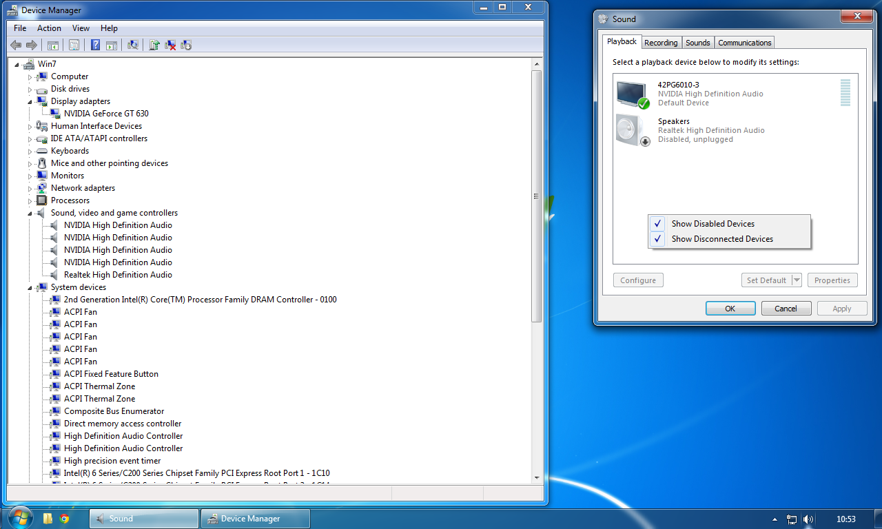

Ecion    6
Done that guys. Still no joy.
see attachment. :)

Detection    2,256
see attachment. :)
Looking at your screenshot, it doesn't actually mention HDMI on the audio device you have selected, it looks like you might have the boards digital out selected and not the cards HDMI
See mine:
Could be you need to install the cards driver again to get the audio working / enable something in the cards settings
EDIT - Just noticed that the name of the device you have selected for Audio is the TV Model number, is it possible that the machine thinks the TV is the sound card rather than the speakers? If you look at mine, it shows that the sound device is the AMD Card, it doesnt mention my TV that is connected to it

Ecion    6
I'm not sure where it got the name from, but its configurable anyway so don't think thats related. I've currently renamed it to HDMI anyway.
