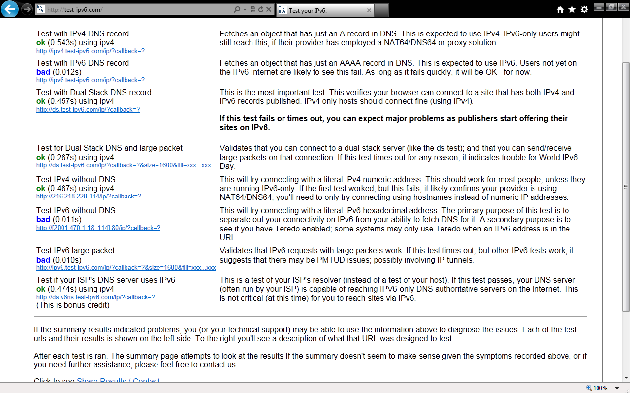

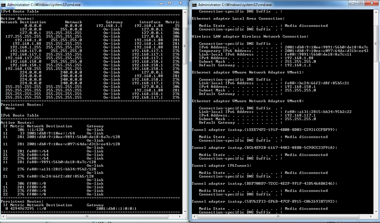

pes2013 Posted October 10, 2012 Share Posted October 10, 2012 Im trying to setup IPv6 tunneling (Hurricane Electric) with DD-WRT but the test sort of fails.... There is the results On my PC everything seems to be passing fine What things could be going wrong? Pinging a IPv6 address just gives General Error, nothing else Link to comment Share on other sites More sharing options...
+BudMan MVC Posted October 11, 2012 MVC Share Posted October 11, 2012 I don't see a ipv6 gateway?? Kind of hard to go anywhere without a gateway Where is your DNS as well? Oh -- you just did ipconfig not /all Link to comment Share on other sites More sharing options...

+BudMan MVC Posted October 11, 2012 MVC Share Posted October 11, 2012 No I didn't say he had to set it manually. Router discover should pick it up, but he prob as something not quite right there. Just noticed on his routes -- he added default route -- but that is not in the same prefix edit: Just looked a little deeper, where did you get your IPv6 IP range from to setup?? That didn't look like a HE range to me. inet6num: 2001:0DB8::/32 netname: IPV6-DOC-AP descr: IPv6 prefix for documentation purpose country: AP admin-c: HM20-AP tech-c: HM20-AP status: ALLOCATED PORTABLE remarks: This address range is to be used for documentation remarks: purpose only. For more information please see Not sure how your going to go anywhere with that address? Link to comment Share on other sites More sharing options...

+BudMan MVC Posted October 16, 2012 MVC Share Posted October 16, 2012 Well for starters he was never anywhere close to having it setup. He did not have an ipv6 address that is even valid, let alone from HE. 2001:0DB8::/32 Not sure what guide he used, maybe they were documenting what how to set it up with the documentation prefix he used and he used that vs what he should of used per his he tunnel info given on the HE site when he created his tunnel. Link to comment Share on other sites More sharing options...
The_Decryptor Veteran Posted October 17, 2012 Veteran Share Posted October 17, 2012 http://www.jmedved.com/2012/01/ipv6-in-your-local-network-via-dd-wrt/ I'm not sure why this guy is using that prefix (or why HE is apparently giving it to him), but there you go. @ the OP: You need to use the details HE.net give you, you can't put in this guy's IP range (if it was valid) and expect it to work. Link to comment Share on other sites More sharing options...
+BudMan MVC Posted October 17, 2012 MVC Share Posted October 17, 2012 Yup that must of been the guide He must of missed this part interface br0 { AdvSendAdvert on; prefix 2001:db8:9:10ee::/64 { }; }; Notice that prefix is same text ?Routed /64? under your tunnel details. Notice that prefix is same text ?Routed /64? under your tunnel details. The guy using it in his guide is fine - in fact that is what the prefix is suppose to be used for, documentation ;) Link to comment Share on other sites More sharing options...
