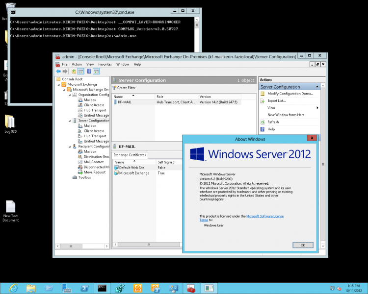

Exchange 2010 doesn't currently work on server 2012, hopefully it will with a future update. Because of this I'm using Exchange 2013 Preview at home lol
Exchange 2010 does "work" on 2012 actually. I'm using now in a live production setup too (bad bad! I know, boss doesn't like "it's supposed to based on X" - wants to see it working before he commits to costs). - used this to get it installed:
http://syscomlab.blo...ws-server-2012/
Not to say there aren't a few little issues but those are from Upgrading from SBS 2003 R2 to Exchange 2010. It's not supported obviously but it is running now in a Hyper-V for testing - currently synced with the SBS 2003 R2 Exchange.
There's the can't install SP2 RU4 (error 1603) but that's not specific to my setup as people with 2008 R2 and 2010 having issues too.
