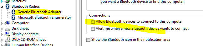

Wow I tap myself on the back on this. I just found out that the culprit of all my headaches is BLUETOOTH.
After either disabling the device or removing the ability to devices to connect my PC, the problem vanished.
I now max my bandwidth easily. I wonder how it was affecting my wireless signal. Certainly not "outside" the notebook because notebook(a) was not affected by this. It was messing it up internally.
OH WELL :) Thanks for the replies guys
