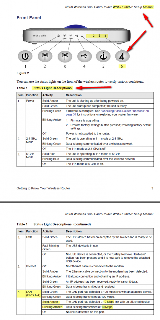

I have an netgear WNDR3300 router, and was wondering if anyone knows what the different color lights indicate? I am referring to the one on the front panel for the ports. Most of the time they are green, but lately the one for the Magic jack is amber, I looked though the manual and found nothing about the lights.

When the light is orange, it means that particular device is connected at 10Mbps rather than 100Mbps.

Just boggles my mind to be honest.. I am the first to want to help people - but come on really. You looked through the manual and could not find this??
Not page 42 out of 400, or something - page 3 under getting to know your router ;)

Well tbh, the only thing I have as far as documentation is the online version, and I did search the document and it came up with nothing... this is the documentation I have, note that there is no chapter titled getting to know your router, so obviously this document is different then the one you showed.
