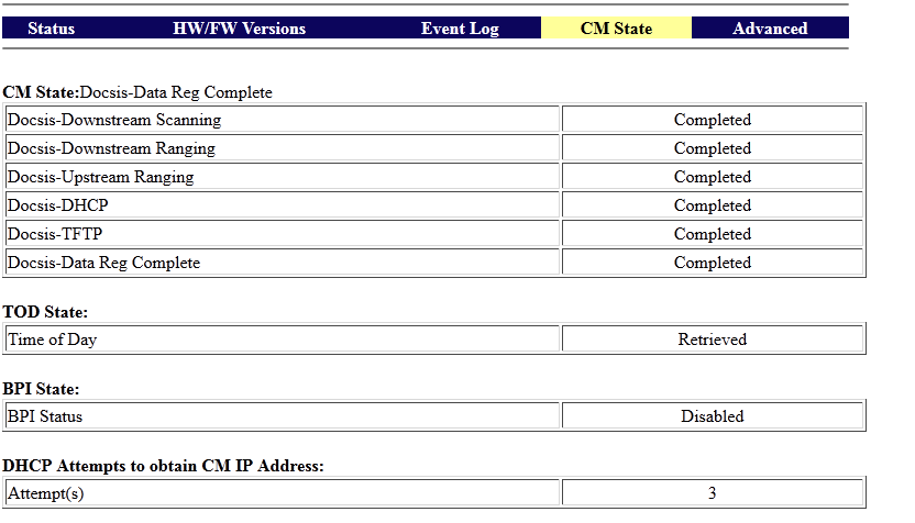

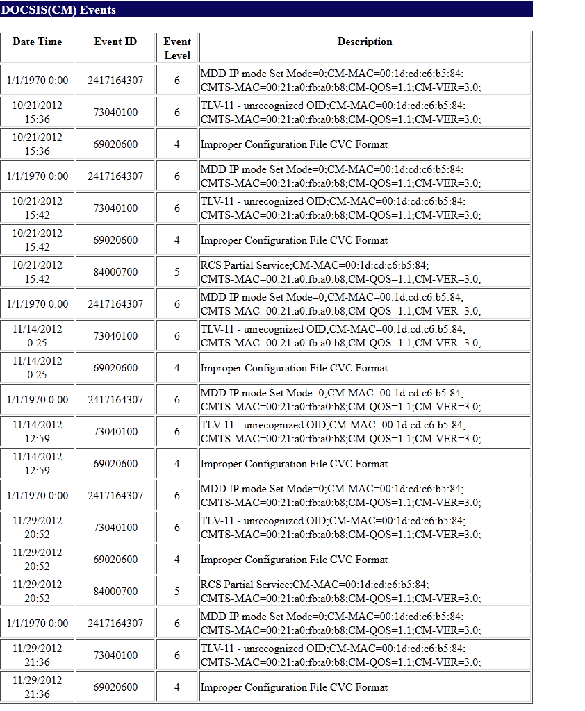

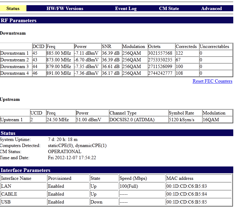

I attached some screen shots. The only thing that says DOCSIS 2.0 is upstream apparently. Other than that stuff, I am not sure if anything is wrong
Not sure about your screens, US looks different to UK comparing it to my modem stats
Check what speeds you should be getting on 3.0 and 2.0 and take a speedtest to compare them

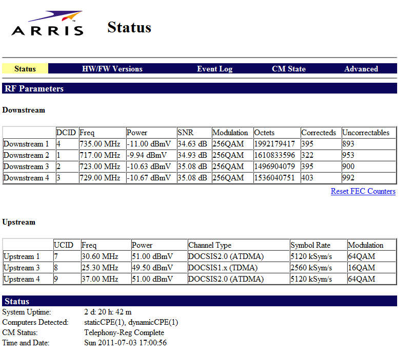

Roger H.    773
Hehe, NOTHING is wrong there. Upstream is generally always D2:
Check that one out which is in D3 mode (since multiple upstream channels) but still shows D2 for the individual channel or even 1.1!!! :o . You are trying to fix what's not broken. :pinch:
Why do you have to reboot the modem though? It just gets so slow that rebooting it is the only fix or what?
Stole that image from Comcast's Upstream Bonding thread on BR:
http://www.dslreports.com/forum/r26047253-Evidence-of-Upstream-Channel-Bonding-Post-Here
