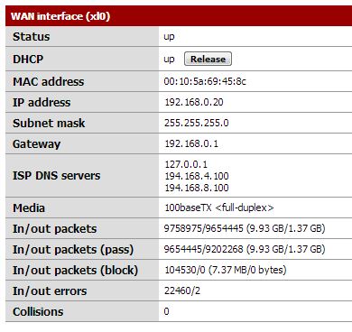

Here is the WAN status:

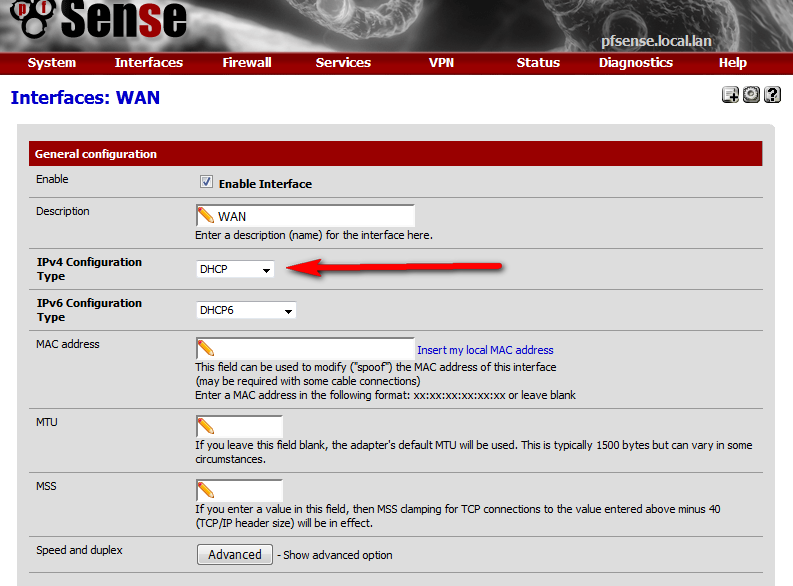

As you can see here the WAN interface is using DHCP, should I change this setting to assign a static IP to resolve this issue?
I don't see the reason for the dhcp on the wan and you want it to be static.
What is the lease time? it should work the way you have it set, even if the isp router reboots - there could be some down time until the isp router finishes reboot, etc.
But you could have a problem with the interface going offline when the router reboots and then coming up again as the ports go active but not getting an IP right away if router has not finished booting, etc.
Couldn't hurt to make it static - so if your isp routers dhcp is say 192.168.0.100 to 150 or something then make your static on the pfsense for something outside that range say 192.168.0.99 or less or .151 or more. That would not conflict with any other devices on the 0 network.
And this should remove any issues with dhcp taking a bit to come back, etc.
When you have the issue - what does pfsense show for its wan IP? Can you ping the isp routers IP? You can do that from the diag tab or from the shell of the pfsense router.

DHCP lease time on the ISP router is 1 hour, last time it was restarted it was 3 hours before I returned home to discover a lack of internet. WAN IP remained the same after, presumably due to the fact that the WAN interface most likely remained up during this time instead of coming down and then back up.
I have assigned a static IP now to WAN, hopefully next time ISP router requires reboot I shan't run into the same issue.
