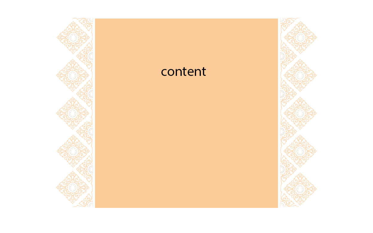

I know little about web design but have offered to put up a one page site for my brother. He sent me this image as a concept.
The problem I am trying to get my head around is how to do the borders of the content. He would like the flower design to be repeated so no matter how wide the browser is, the flower pattern can be seen. If the border between the content and the background was a straight line then it would be simple case of repeating a single flower. However, given that the border is made up of halved flowers, I cant figure out how to do it without either making each side of the content a massive image or having the border overlap the background images and ruin the pattern.

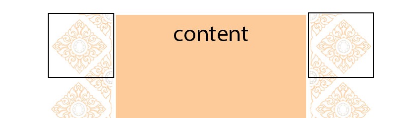

Take the highlighted blocks below, and try using the image-border css property.
