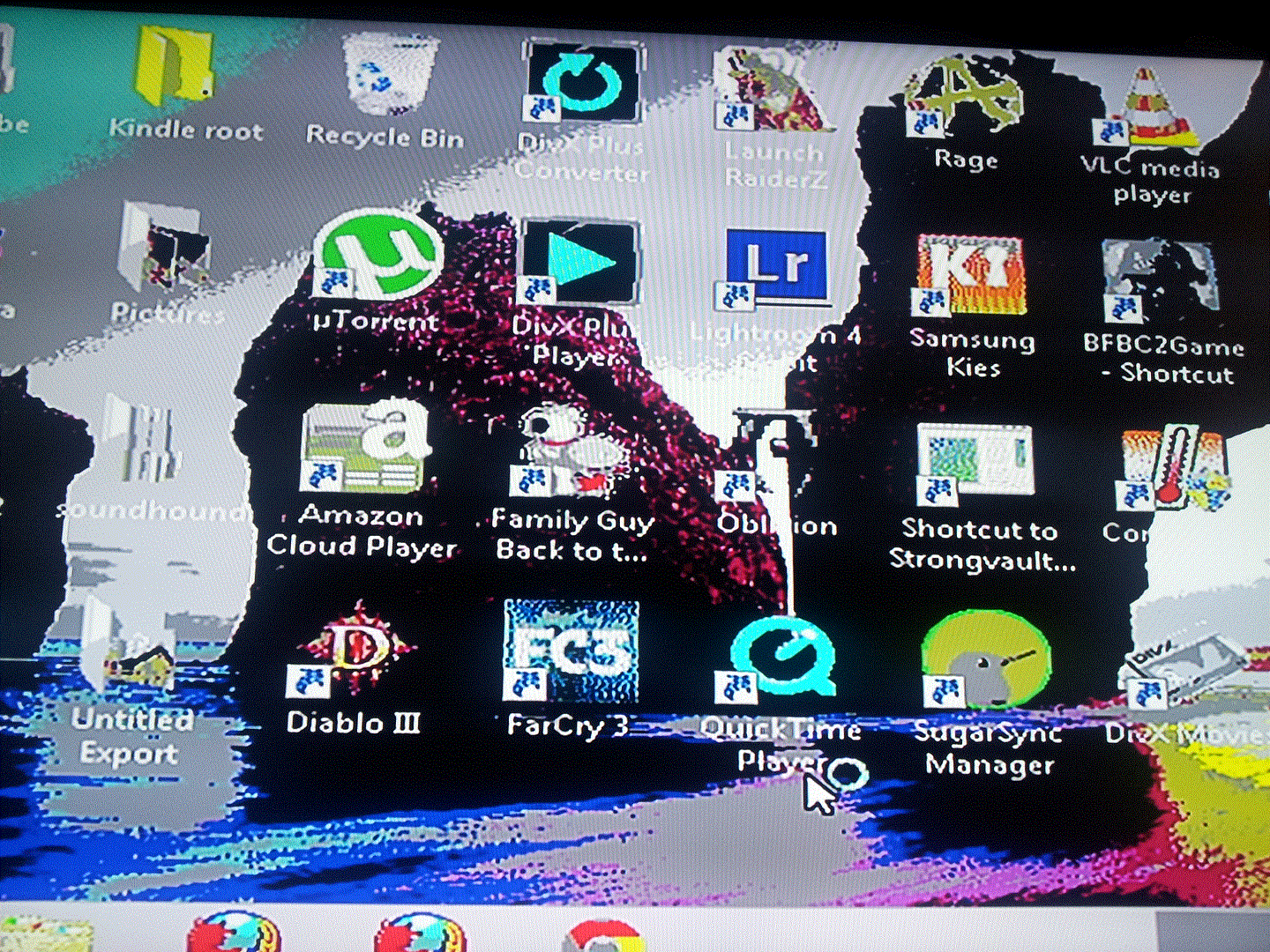

Colin Bisson    0
So I was playing some Diablo 3 tonight and my computer froze. I rebooted and saw these two lovely screens.

Colin.B    24
Sorry about that - I was logged in to an out of use FB account on my phone and didn't realize it. Plus, I wasn't able to upload those images.post-45347-0-70704000-1358235982.gifpost-45347-0-45737700-1358236013.gif
I guess the whole reason I was thinking PSU (and forgive my ignorance) is things just started crashing..For example, I opened Chrome and it just ran sluggish and unresponsive. Even trying to pull up the task manager to end the task was delayed and after the system "caught up", I had to restart to have any type of performance I could use. I just didn't think a GPU could cause those issues. Again, my own ignorance.
