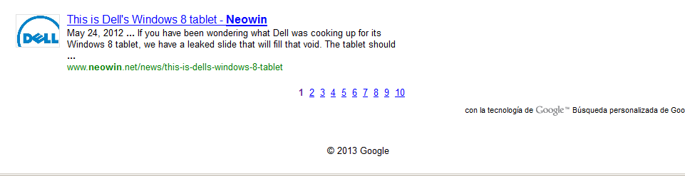

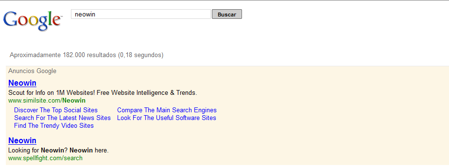

Every time i try to google anything it redirects me to this website.
I tried Reset FF
I tried AdwCleaner.exe, Search & Destroy, Malwarebytes' Anti-Malware, SUPERAntiSpyware, Spyware Terminator 2012, Trojan Remover
with no luck :(
Any solutions?

http://www.google.com/cse?cx=partner-pub-9609672093949948%3A2pdkvfm6u5y&ie=ISO-8859-1&q=3&src=#gsc.tab=0&gsc.q=3&gsc.page=1
