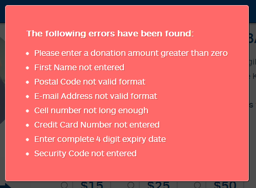

I'm very happy with the prevalidation and how it works. Basically the way I've achieved it is like so:
function verifyForm() {
    var message = "";
    message += verifyAmount();
    message += verifyFname();
    message += verifyLname();
    message += verifyAddress();
    message += verifyCity();
    message += verifyPostal();
    message += verifyEmail();
    message += verifyCell();
    message += verifyCC();
    message += verifyExpiry();
    message += verifySecurity();
    if (message == "") {
        document.forms["theform"].submit();
    } else {
 TINY.box.show({html:'<ple="font-weight:bold; padding-bottom: 10px;"&gt;The following errors have been found:&lt;/p&gt;' + message,animate:true,close:false,boxid:'error',top:5})
It runs all the subfunctions and then either forwards the form dependent on whether the "message" variable is empty or not.

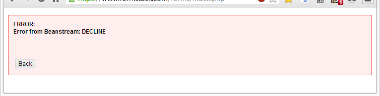

Now here's where things become a bit sketchy for me, and I don't really know where to go from here. I'll explain the next process:
  1. Form passes my pre-validation
  2. Form gets sent to third party server
  3. Third party server returns error such as "credit card declined" - this error cannot be pre-validated by my code.
  4. Third party server display error in the .php page uses for submission like so:
I want to capture the php response from form submission. Not load it in a new page as it already does. and then parse the response into an error similar to the one in the first screenshot.
Does this all make sense?
Cheers.
Alex
  • 0
It's actually a strange process.
I'm using Formstack to process the forms. Formstack then send the form data to the payment processor Beanstream. Formstack also offer integration to various payment processors.
What happens is the POST data gets sent to https://www.formstac...forms/index.php with the form ID and various other unique data in hidden fields. The fields including name, credit card number are all appended to this and then when Formstack receive the data, that is then forwarded to Beanstream to process the payment. Beanstream will then respond to formstack with the outcome.
If the card is accepted, it can redirect to a custom thank you page.
If card isn't accepted, it just displays a generic error page "decline" which is not in keeping with the website.
I'd rather create my own error page OR display the error within the current page. I'm just fairly stumped as to how to go about it. After reading through formstack's REST API documentation I can't seem to see anything which indicates how this can be achieved. It seem to be mostly concerned with accessing form data that has been submitted rather than the process of form submission and error responses.
