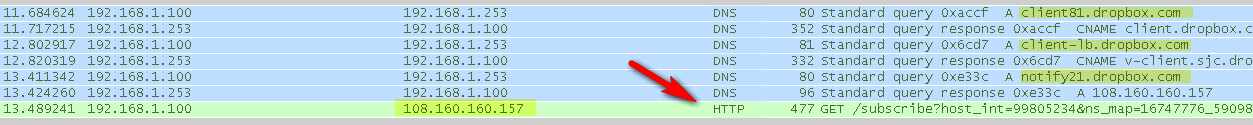

+BudMan    2,895
Yeah you can ping google.com - so there should be no reason why dropbox would not work other than software firewall issue, dns problem? Let me fire up a sniff real quick and tell you where it tries to talk
edit: ok after a quick sniff
So you can see a few queries for client and notify dropbox.com - I would see if you can get those to resolve - simple ping to the names should tell you if they resolve, don't worry if they don't respond.
And then you can see it talking to one of those IPs via just HTTP, so no weird port involved, etc.

Actually, it makes sense in a kind of way. Since the developer of the software, Ipsos is a market research company, they may have been experimenting with a way to monitor user behavior by intercepting network traffic. As such, it is unsurprising that such a feature would break network-aware apps, especially those that use SSL, communicate in non-standard ways and so forth.
Regards,
Aryeh Goretsky
Odd that it would break internet for a couple of programs??
Share this post
Link to post
+BudMan    2,895
Yeah that makes perfect sense - why would anyone install such crap in the first place?
Sure we are talking about the same company?
"Access Panels that is in closed alpha testing"
When I search for panel+ and access panels, etc. it seems like software to manage/monitor power related equipment.. Why would someone want to install a closed alpha/beta copy of "crapware"??
But yeah I agree if that is the type of software it is, your lucky anything was working.
