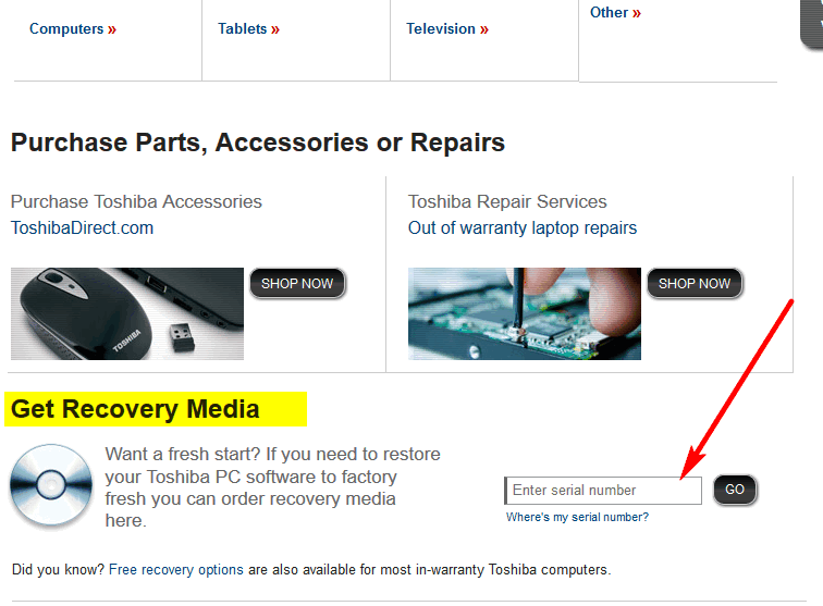

If you do not have media you can install, what did you recover off the recovery partition - was it an actual wim file?
Most likely your best bet is to contact toshiba for recovery media.
https://support.toshiba.com/repair

+BudMan    2,906
If you have an install wim, then yes as mentioned by zhangm it is possible to apply that wim. ImageX is the tool which is part of the WAIK that can be used yes.
Its prob going to be much easier if you just order the recovery media ;)
