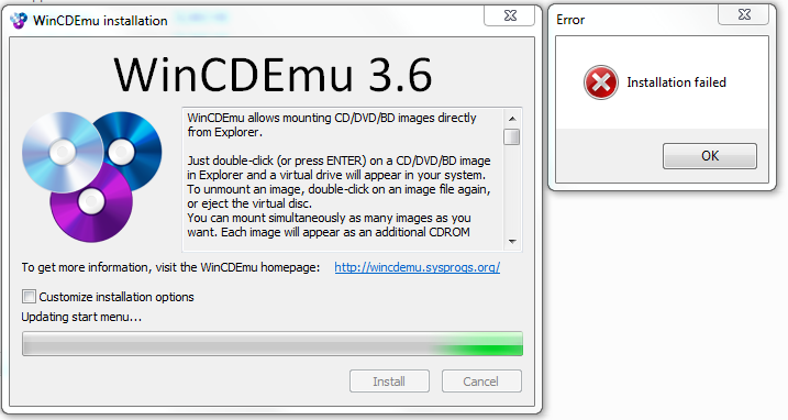

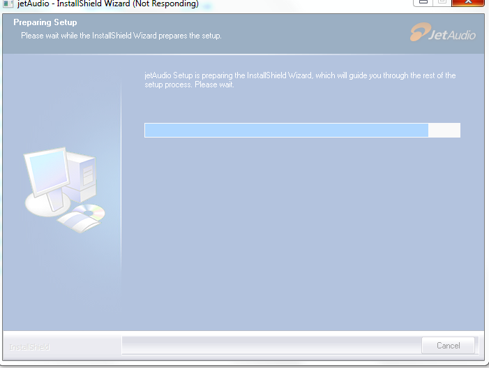

Just got windows installed and updated, now when I try to install certain program like Cowon JetAudio, or Wincdemu, they will not install. Jetaudio launches the install shield and the progress bar moves, but then it freezes and eventually fails to install. With Wincdemu, as soon as I click ok to install it says install failed. It does prompt for admin privileges to install. I have run a SFC/scannow and it reports nothing wrong. The HDD is brand new, and SMART status shows that everything is OK... what could be causing this issue?

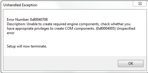

In terms of the InstallSheild setup, something is preventing the COM component InstallSheild uses during setup to be registered.
Add the installer to the DEP exclusion list and try again.
Add the installer the DEP exclusion list and trying again.
