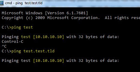

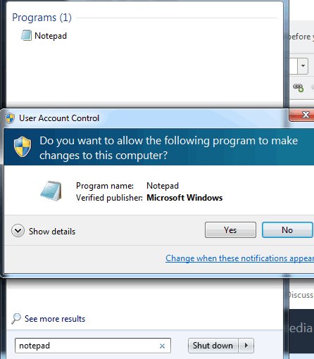

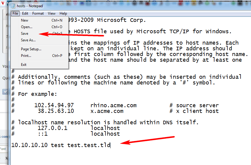

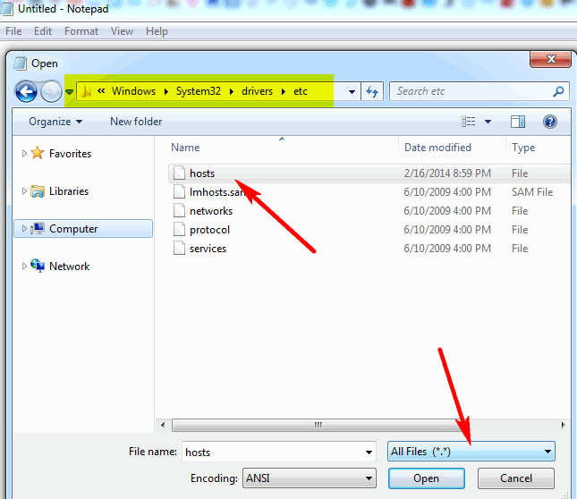

So this is not hard people
Run as admin
Open file
Edit file and save
Works
Some of the suggestions in this thread are just way out there..

+BudMan    2,921
The host file while a system file, is meant to be edited - but since accounts no longer run with the admin token to edit you must be elevated to have access.  This is for your own protection, so if you run some bad code system files like the host file can not be edited sending you to the wrong place for google or preventing access to antivirus sites, etc. etc..
