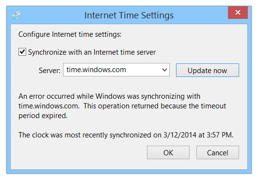

Hi everyone.
I have Windows 8.1, and over the last 2 weeks, I have noticed that my time is not keeping accurate.  I can go in and sync it, and it will correct itself (With an error that it timed out...), but a couple of hours later the clock will be wrong again.  I have tried changing the Time Sync Server, Restarting the Time Service and setting it to Automatic, etc, but nothing seems to help at all.
Does anyone have any ideas?  This is really driving me nuts at this point...
Thanks for your help.

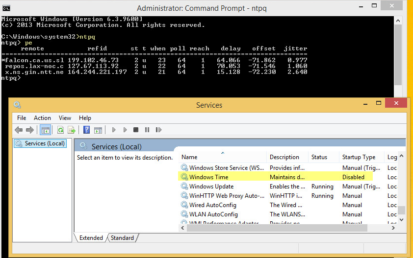

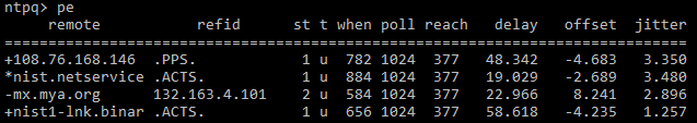

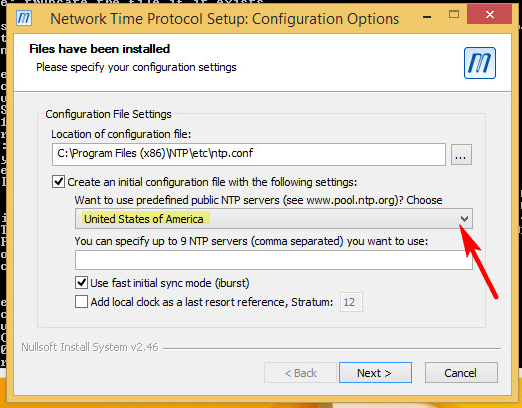

For troubleshooting time sync problems there is nothing like the actual ntp tools to work with..  ntpq can give you lots of information about the server your syncing too, etc.  With the actual ntp client you can get lots of details for troubleshooting time issues.
Now as of late there has been some major attacks being done with ntp, many of the ntp servers out there have had an issue where you could query their monitor list to the IPs using them - and this can be used in an amplification attack.. Its possible your ISP has blocked udp 123 which is the standard port ntp uses.
I would be pretty ###### if they did that - but without some actual tests its hard to say if this is the case or not.  Do any of your other machines have problems syncing time?  Where are you pointing to for your ntp server?  You can grab a windows copy of ntp from here - http://www.meinbergglobal.com/english/sw/ntp.htm
Should work on win8.. From there you can use tools like ntpdate and ntpq to get lots of info.. But with the built in tools you should be able to use w32tm to do a quick query to see if you can talk to the ntp server of your choosing, etc..

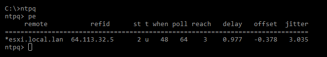

So as you can see doing a query against my own local ntp server, and then against one that is in the pool for ntp.org  Reporting offset, etc.  If you can not do get something like this to work to any ntp server off your network then its quite possible your isp is blocking ntp (udp 123)

Thanks everyone for your help.  Do you mean the battery on the board?  In the past, I've had computers with an issue at boot where the time was not maintained, but this one loses time while in use, which I find particularly odd.  I initially thought possibly something malicious, but after scanning with Norton, AVG, IOBit, and SpyBot, I don't think that's the issue at this point (Hopefully).  I have not noticed any odd processes either.
And yes, when I try to synch the time with the time server (And I've tried several), I get the error message below:
And while I get this error, the time still gets updated.  This is what originally led me to believe it was something malicious, because it was almost as if there was something between me and the time server...
I don''t think this is a result of the ISP blocking anything either, as this occurs both at home and work and those are both different ISP's.  One of them is Verizon, so I imagine a lot of people would be screaming if they did that...

I also spoke with ASUS support (This computer isn't more than a year old).  As a result, I would hope that the CMOS Battery wouldn't be bad already.  They recommended a Windows Refresh, which wouldn't be ideal due to the amount I would lose and have to reinstall.  He said that changing the battery would void the  warranty...  Not that it probably matters if I don't have a computer that works...  lol
As for new software installed around the time this started...  I did not install anything recently.  A couple of weeks before this occurred, I installed IOBit, and since I've installed AVG...  But nothing around the time this started.
In reading up on the CMOS battery as well, it doesn't sound like this would affect anything while the machine was running, but I of course could be wrong.
This is by far the strangest issue I've ever run into with a machine.
Hi everyone.
Choose a different server. This error you have has been happening on all versions of windows (down to Windows XP). I think each server doesn't allow multiple attempts in one day.

Here is my time server I run, uses multiple public servers and picks the best one..  Polling is currently at 1024 seconds - this is MAX polling time for ntp..
server ntp2.netwrx1.com
server nist.netservicesgroup.com
server ntp.mya.org
server nist1-lnk.binary.net

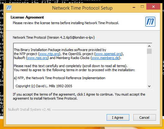

And yes the ntp window port runs just fine on windows 8 or 8.1 - here I installed it on my 8.1 box

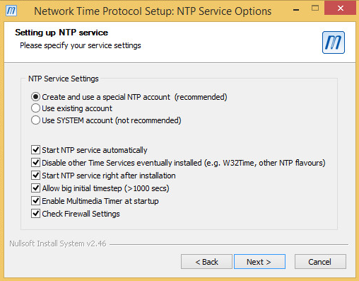

Next Next Next until asked what time servers you want to use - hit the drop down and pick your region of the world
Then you will see this page - just leave everything it will then ask you for ntp account password, and disable the built in service, start the service, etc. etc..
You can then open a cmd window (needs to be reopened if still using old one so that new path is gotten) So you can run ntpq which is a way to look a your status.  Then run pe and see how your doing.
So here you see it disabled the built in service and its doing queries to ntp servers - it starts off doing quick polls, but as it gets answers it will back those off to longer 1024 seconds, etc.

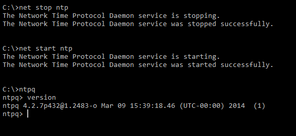

Now the software from meinburg is a bit dated - if you want to run bleeding edge version you can get from here http://www.satsignal.eu/ntp/x86/index.html
I am currently running on this main workstation
C:\>ntpq
ntpq> version
ntpq 4.2.7p416@1.2483-o Jan 31 13:45:44.41 (UTC-00:00) 2014  (1)
ntpq>
But might as well update to 432, you just download his zip and stop the service and replace the binary files - there you go bing bang zoom latest and greatest ntp client/server
As you can see it just restarted and polling my local server at 64 seconds
