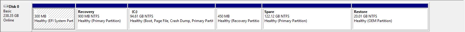

Noig Posted April 29, 2014 Author Share Posted April 29, 2014 Aergan I have the 8.1 DVD ready and wonder where would be the best position on my disk to create the partition for 8.1? See my SSD disk below Link to comment Share on other sites More sharing options...
Noig Posted May 6, 2014 Author Share Posted May 6, 2014 You can go from VHD on VM to VHD on physical or convert VHD to physical but you'll likely need to go via sysprep /generalize /shutdown beforehand... Hi Aergan I have prepared a USB install and have continued to the point , just before installing. Just to see if there would be anything that would pop-up. Got the following: "Windows cannot be installed on this disk. The selected disk is of the GPT partition style." How come, as the existing install is a win 8 pro? Would you be able to elaborate? Thanks Link to comment Share on other sites More sharing options...
Aergan Posted May 6, 2014 Share Posted May 6, 2014 Hi Aergan I have prepared a USB install and have continued to the point , just before installing. Just to see if there would be anything that would pop-up. Got the following: "Windows cannot be installed on this disk. The selected disk is of the GPT partition style." How come, as the existing install is a win 8 pro? Would you be able to elaborate? Thanks Your USB install must boot using UEFI mode, not legacy mode. That means formatted as FAT32 (Not NTFS as one would for a legacy WIndows 6.X install). Use Rufus to prepare your USB: http://rufus.akeo.ie/ Link to comment Share on other sites More sharing options...
Noig Posted May 7, 2014 Author Share Posted May 7, 2014 Your USB install must boot using UEFI mode, not legacy mode. That means formatted as FAT32 (Not NTFS as one would for a legacy WIndows 6.X install). Use Rufus to prepare your USB: http://rufus.akeo.ie/ Aergan Done exactly that(just have to recheck) as also shown here with Rufus. Maybe something went unnoticed wrong while setting up Rufus and loading the iso? Is it GPT partition scheme for UEFI? Link to comment Share on other sites More sharing options...
Aergan Posted May 7, 2014 Share Posted May 7, 2014 Just checked mine, I have all three setup as "FAT32 + GPT for UEFI computer" - Windows 8.1 Update x64 Professional, Windows 8.1 Update x64 Enterprise and Server 2012 R2 Update x64. On my Dell, I have to disable legacy boot mode to force it to boot in UEFI mode otherwise it automatically boots into legacy mode. Good tutorial of the process here:http://www.eightforums.com/tutorials/15458-uefi-bootable-usb-flash-drive-create-windows.html Link to comment Share on other sites More sharing options...
Noig Posted May 8, 2014 Author Share Posted May 8, 2014 Aergan It took some effort though I made it, and it works perfectly the way the dual boot is setup. Nice interface. Thanks for all your efforts! :) Aergan 1 Share Link to comment Share on other sites More sharing options...
Aergan Posted May 8, 2014 Share Posted May 8, 2014 Aergan It took some effort though I made it, and it works perfectly the way the dual boot is setup. Nice interface. Thanks for all your efforts! :) No worries, glad you're sorted. Link to comment Share on other sites More sharing options...
