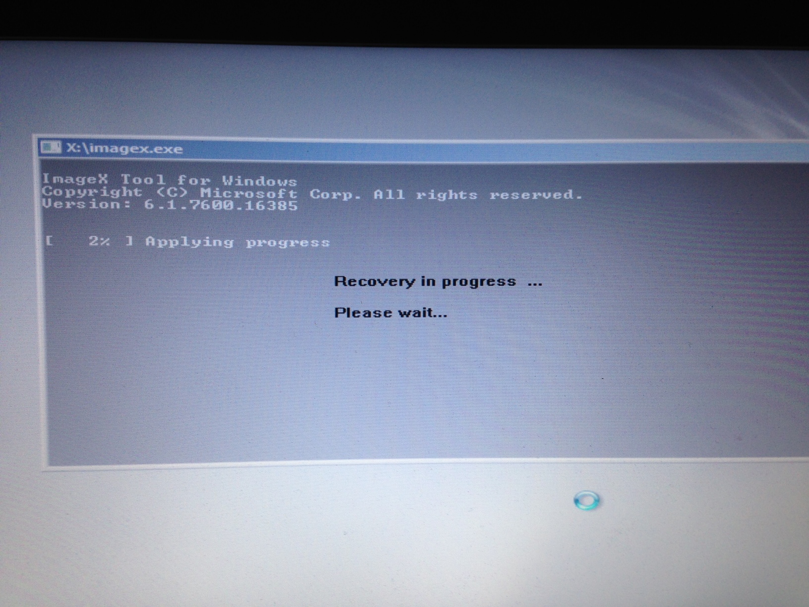

SlayerS_BoxeR Posted June 30, 2014 Share Posted June 30, 2014 I have an Asus laptop, and after reinstalling windows, I got BSOD. I then restarted the windows and I was waiting for windows diagnosis - whether I waited or pressed cancel to proceed, it just stopped working. So I thought I should reinstall the windows (Recover Windows to first partition only), but this time, I can't even reinstall/recover. Here's the sc I have attached. It just stops at 2% and later shows Error Recovery. Has it completely died? Do I have to buy a new laptop? Link to comment Share on other sites More sharing options...
LittleNeutrino Veteran Posted June 30, 2014 Veteran Share Posted June 30, 2014 Did the computer come with any sort of recovery media rather than using a recovery partition? ImageX isnt truly installing windows. it is taking an image of an installed Operating System and putting it in a specific location (rather like Ghost imaging) It could be that the WIM file in your Recovery partition is either corrupted or damaged. or that the partition you are installing to has an issue. I suppose if you have direct access to the WIM file you could run a check on it to see if it is corrupted. If you can get into a command prompt and have access to the file run the following command on it. imagex /mount image_path {/check } Link to comment Share on other sites More sharing options...
SlayerS_BoxeR Posted June 30, 2014 Author Share Posted June 30, 2014 Did the computer come with any sort of recovery media rather than using a recovery partition? ImageX isnt truly installing windows. it is taking an image of an installed Operating System and putting it in a specific location (rather like Ghost imaging) It could be that the WIM file in your Recovery partition is either corrupted or damaged. or that the partition you are installing to has an issue. I suppose if you have direct access to the WIM file you could run a check on it to see if it is corrupted. If you can get into a command prompt and have access to the file run the following command on it. imagex /mount image_path {/check } don't have any recovery media, and basically can't do anything other than pressing f9 of the recovery setting :( Link to comment Share on other sites More sharing options...
