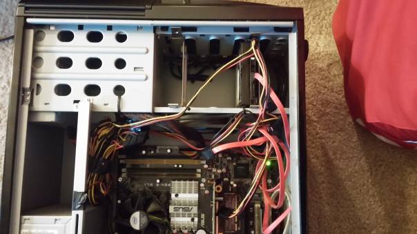

I have attached a few pictures of what I am working with.
My grandfather just wants to upgrade this DESKTOP ...its really old but we wanted to make a few upgrades.  These were the upgrades that I am considering
1) The Hard Drive (how to change this to SSD)  I believe this is a Serial ATA Internal Hard Drive.  I am looking at using the existing desktop hook ups to install a SSD with Windows 7 on it.
2) Also would like to upgrade this RAM.  I have two slots left.
Is this the correct RAM?
2GB PC6400 DDR2-800MHz PC2-6400 240PIN DIMM Desktop Memory RAM
3) Is there anything else I can upgrade or should upgrade?
I am on a budget for him and just trying to help out.  I knew you guys would have the answers.  I love this place and the great advice.

Going by your pic you have three sticks of ram installed but yes that is the right ram.

I looked up the motherboard: http://www.asus.com/Motherboards/P5NE_SLI/specifications/
It only has SATA II connections, which will mean that when you get a SSD drive, it will be limited to roughly 275-300MB/sec. Which is still 2-3x faster than a HDD, but don't go for any top of the range ssd's because that'll be a waste of money.
To install and connect the SSD, you might need a Molex to Sata, power connector, like the picture underneath, but you may have a free sata power connector available in the case, can't tell from the picture.
On the photo I can see at least 2 free molex connectors to connect it to. You might also need a 2.5 to 3.5inch harddrive adapter to fix the SSD in place, most SSDs are 2.5 inch. Or you could just decide to have it lay on the bottom of the case under the harddrive that's already installed.

Maybe only 2. Looks like the right black one is empty ;)
Possibly slap in a better graphics card, a lot can be/is shifted to the GPU now. Also what CPU is in it? You may be able to get a cheap better one of Ebay...

  Peter we have two sticks of RAM in there so that leaves me with 2 slots.  Would upgrading 4GB more help at all?
sinsofcube there are plenty of power connectors i think see pic attached.  So I can get 4GB more.  Shouldnt that make a difference with load times and start up?
He really is just a Google Chrome user.
Do you think adding the SSD would be worht it speed wise?  And is it hard to do?

its and Asus P5N-E SLI
Intel Socket 775 Core?2 Quad/Pentium? Extreme/Pentium? D/Pentium? 4/Celeron Processors
So game plan is to keep the already existing 4GB RAM and upgrade to SSD.
What do I need to connect the SSD like converters and he will only need a 64GB or the cheapest I can find for best speed.

Yes that would work perfect. Warranty is usually the key factor, and when SSDs die, they die. no "well I can recover some data!" You will need to ensure you have a 2.5" bay or a 2.5" to 3.5" adapter kit to mount the drive in your grandpas computer. Theres no moving parts or really wrong way to install it - but securely is recommended. this was the associated amazon link I got for one: http://www.amazon.com/SABRENT-3-5-Inch-2-5-Inch-Converter-BK-HDDH/dp/B00G57BN1M/ref=pd_bxgy_pc_img_y/184-2030690-4522835
I'd suggest looking into doing backups, windows offers this in windows 7. Maybe keep both drives in the machine and use your current for storage and your new SSD for a boot device with windows on it. I think theres also a windows migration tool too, but I'm old school and could do it with a linux boot disk and cli.

That would do, but it's an old drive and you're not getting much value for money (high cost per gigabyte).
I'd just go for this: http://www.amazon.com/Crucial-MX100-adapter-Internal-CT128MX100SSD1/dp/B00KFAGD88/
They're cheap, high quality, reliable, fast, ... Should you ever move the HDD in a few years you'll be better off with this. And 60GB might just be a little tight at some point if you're going to have some photos on there for example. And it's just much better value.
Add this and you've got all you need: http://www.amazon.com/SABRENT-3-5-Inch-2-5-Inch-Converter-BK-HDDH/dp/B00G57BN1M/
