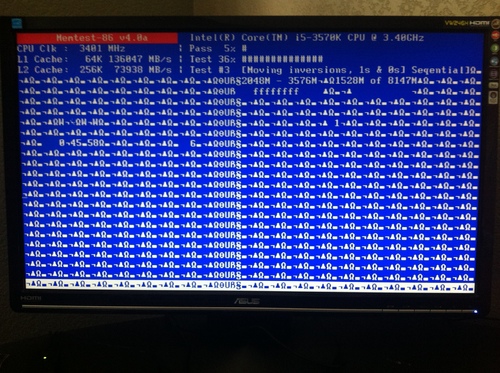

Lades Posted July 30, 2014 Author Share Posted July 30, 2014 Can you upload a pic of what u mean? ccdn.overclock.net/7/71/500x1000px-LL-71b76794_download.jpeg i found it on google, i hope its enough....i only have "w o" instead of those symbols on screen Link to comment Share on other sites More sharing options...
Robbie Ride Posted July 30, 2014 Share Posted July 30, 2014 ccdn.overclock.net/7/71/500x1000px-LL-71b76794_download.jpeg i found it on google, i hope its enough....i only have "w o" instead of those symbols on screen think u need to adjust the link bud. Link to comment Share on other sites More sharing options...
Lades Posted July 30, 2014 Author Share Posted July 30, 2014 oh sorry, didnt tested it. here it is corrected i hope Link to comment Share on other sites More sharing options...
Robbie Ride Posted July 30, 2014 Share Posted July 30, 2014 oh sorry, didnt tested it. here it is corrected i hope Never seen that before but I think your memory is screwed. btw I thought your system specs were AMD based? If you have more than one memory stick in your comp try and remove one and then run memtest and then swap and do the same, this way you can remove the stick that might be causing the issue. Link to comment Share on other sites More sharing options...
Lades Posted July 30, 2014 Author Share Posted July 30, 2014 Never seen that before but I think your memory is screwed. btw I thought your system specs were AMD based? If you have more than one memory stick in your comp try and remove one and then run memtest and then swap and do the same, this way you can remove the stick that might be causing the issue. on one forum they write about that problem i linked few mins ago....they say that its caused by thing that i use memtest86 and not memtest86+ Link to comment Share on other sites More sharing options...
Robbie Ride Posted July 30, 2014 Share Posted July 30, 2014 on one forum they write about that problem i linked few mins ago....they say that its caused by thing that i use memtest86 and not memtest86+ Try memtest86+ and see what happens, a clear indication of issues would be shown in red. Link to comment Share on other sites More sharing options...

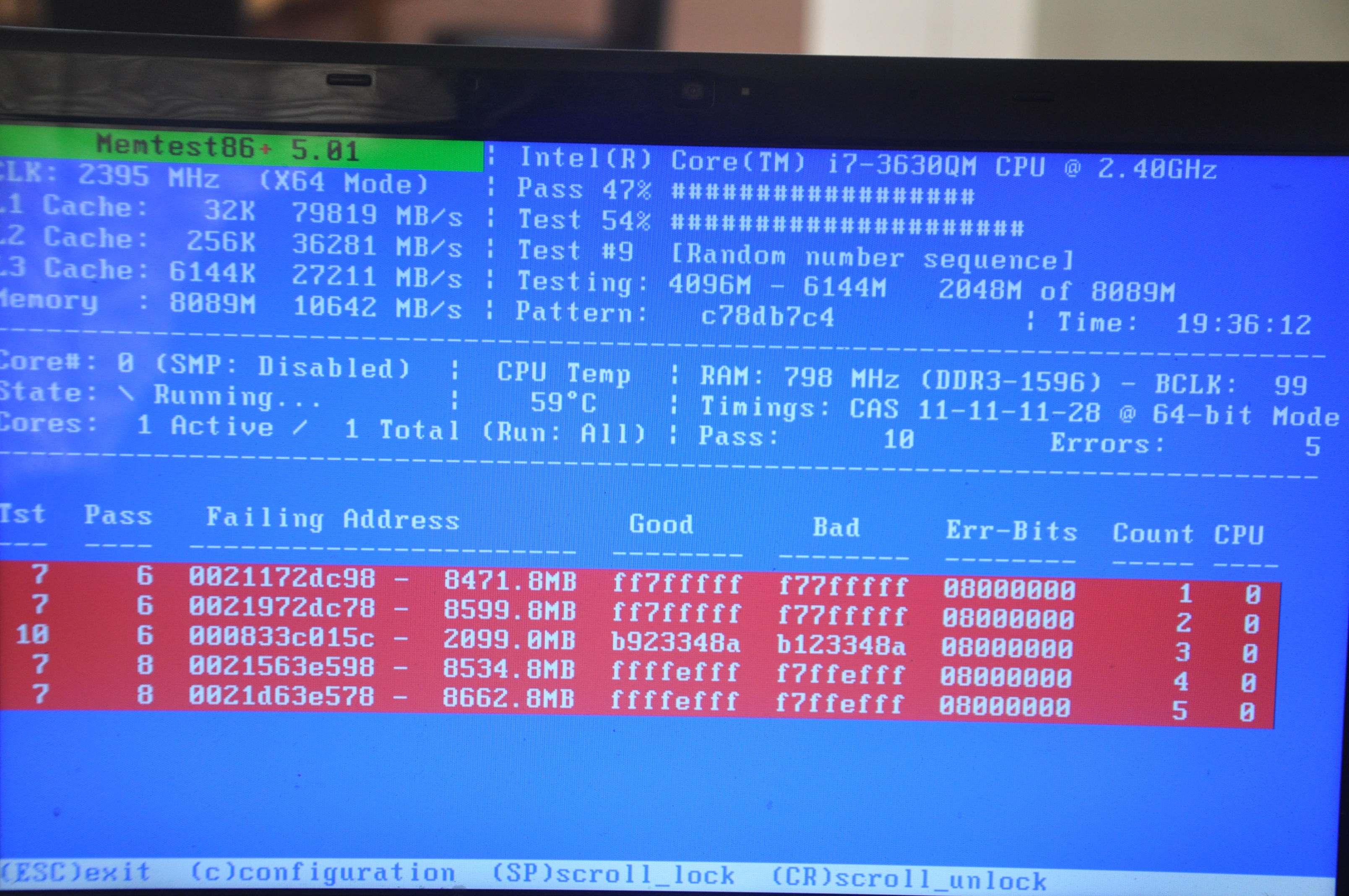

Robbie Ride Posted July 30, 2014 Share Posted July 30, 2014 well still browsing about those weird words on screen :) is it possible taht bad RAM is behind all this problem with BSOD? i mean that first one specially i wanted to install that driver but i was scared when bsod appeared :) Running the chipset drivers isn't gonna cause you or your comp any harm it might however fix your problem but I think the issue is the memory and don't browse the weird words on the screen they ain't really gonna tell you anything. If you do have faulty memory you might see something like this:- Link to comment Share on other sites More sharing options...
