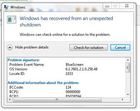

Cosmin    22
Well.. tested it on my second system and under furmark freezes as did on the first one. I quess it's pretty damn clear.
Any other ideeas are also welcome!
Additional information about the problem:
  BCCode:    124
  BCP1:    00000000
  BCP2:    85EDB594
  BCP3:    00000000
  BCP4:    00000000
  OS Version:    6_1_7601
  Service Pack:    1_0
  Product:    256_1
  C:\Windows\Minidump\080414-27515-01.dmp
  C:\Users\Secttor\AppData\Local\Temp\WER-42671-0.sysdata.xml

Sikh    192
Your card is definitely bad. Just RMA it and try to advance replace it if you can
