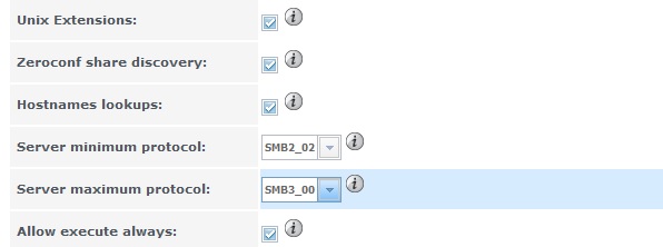

Makes sure to configure FreeNAS to use SMB2, SMB2.1, or SMB3. The SMB2 dialects have much better performance compared to SMB1 (although if you are on Windows XP you won't be able to take advantage of those performance improvements).

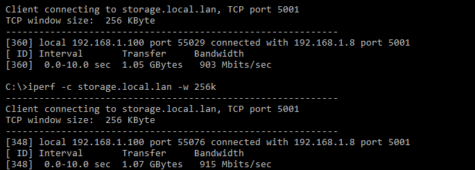

Here is iperf when connected at gig

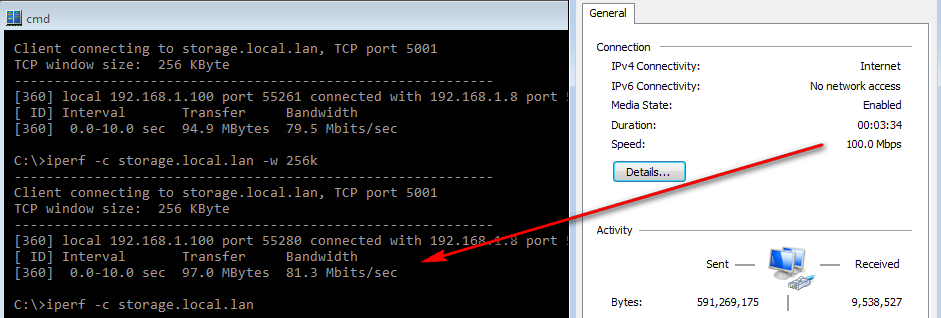

Here hard coded it down to 100 -- moving files at this speed would be like watching paint dry.

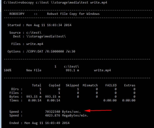

see my above screenshots for iperf.. Here is a ropocopy of moving a file
I do see faster than that quite often..
Here is write

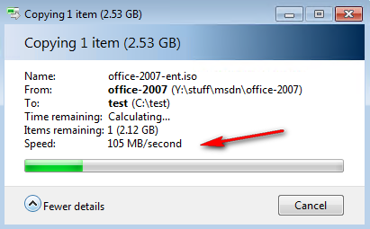

I don't always believe the dialog on the windows copy, and it does fluctuate, etc.. Here I grabbed something bigger so I had time to grab a screenshot
