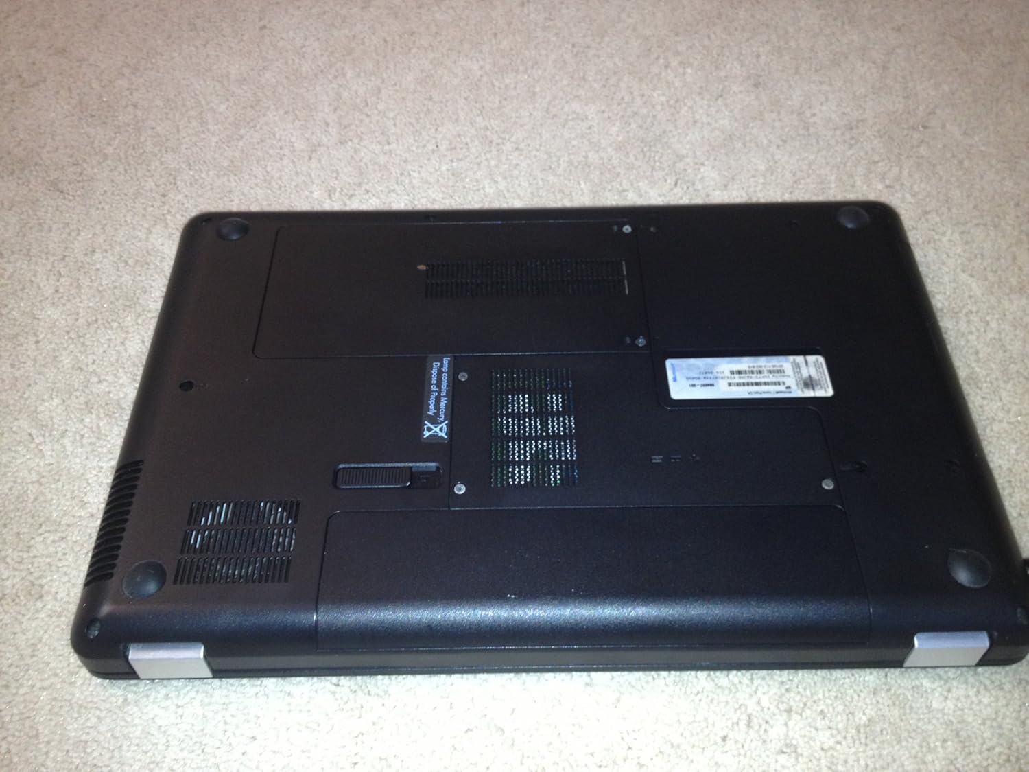

I dont own a key I'm using a pre-activated disk copy that some Frankenstein of a technician gave me. I've used this disk to install once before (a while back). Its on a DVD RW
the key should be on the bottom of the laptop.
as shown here
http://ecx.images-amazon.com/images/I/91nzwiCxIwL._SL1500_.jpg
If you don't have a key all we can do is tell you to purchase a valid copy.
