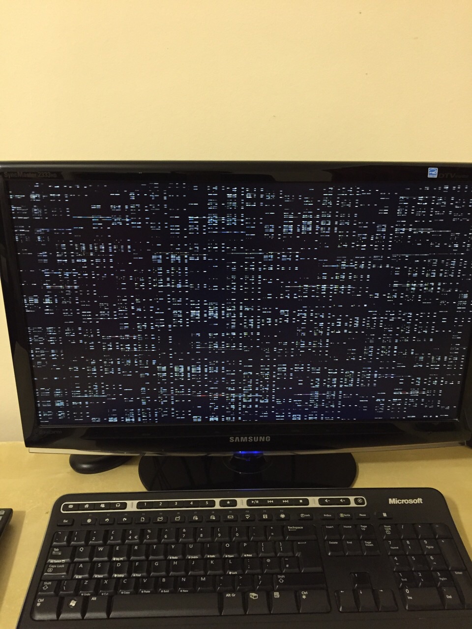

Zoom7000 Posted October 11, 2014 Share Posted October 11, 2014 So, my daughter was just watching YouTube when this happened:So, do you reckon my GPU has just died on me? It displays that during the POST and at all times now. I've opened the case and tried reseating it to no avail. Unplugged and recabled everything and still the same.Anyone know what kinda warranty comes with a Gigabyte 560Ti? Link to comment Share on other sites More sharing options...

francescob Posted October 11, 2014 Share Posted October 11, 2014 What? You can't read through the source code of the Matrix? Nogib, Crisp, Krome and 6 others 9 Share Link to comment Share on other sites More sharing options...

helpifIcan Posted October 12, 2014 Share Posted October 12, 2014 Just to be sure did you try a different monitor and/or cable? Link to comment Share on other sites More sharing options...
Anibal P Posted October 12, 2014 Share Posted October 12, 2014 Just to be sure did you try a different monitor and/or cable? This indeed, was having some issues and turned out to be a dying screen and not the GPU Link to comment Share on other sites More sharing options...
Zoom7000 Posted October 13, 2014 Author Share Posted October 13, 2014 Well, it was definitely the GPU that died. My friend kindly donated a 9800GTX which has at least got me back up running, however, I was just about to buy Final Fantasy XIII and GTAV (Upon release) So, I'll still need to save up for a 750Ti which appears to be the cost and performance equivalent to my 560Ti as I very much doubt the 9800GTX will fair well with those 2 graphical beasts! It's just too bad that EVGA don't do 10 year warranties anymore, but I guess they learnt from BFG's failure! Link to comment Share on other sites More sharing options...

Krome Posted October 18, 2014 Share Posted October 18, 2014 What? You can't read through the source code of the Matrix? lol Matrix got in his system. Link to comment Share on other sites More sharing options...

Andre S. Veteran Posted October 19, 2014 Veteran Share Posted October 19, 2014 Your video card is fine, that's the new Youtube site design! Link to comment Share on other sites More sharing options...
+Anarkii Subscriber² Posted October 19, 2014 Subscriber² Share Posted October 19, 2014 Yep your daughter killed it. Time to send it off to the great circuitry in the sky. Link to comment Share on other sites More sharing options...
