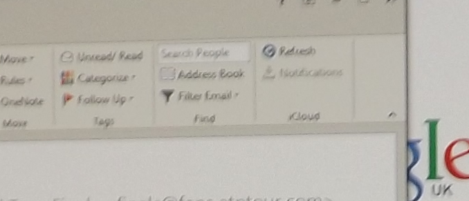

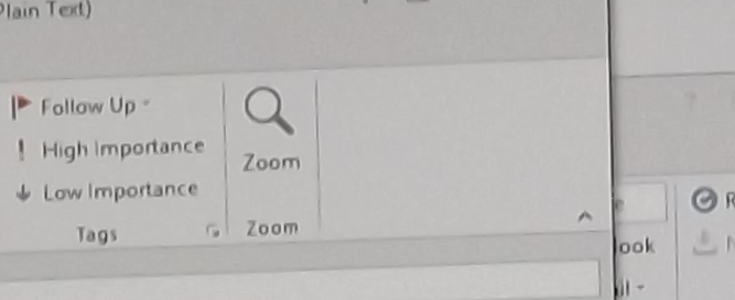

singularity87 Posted November 6, 2014 Share Posted November 6, 2014 I just got a Dell UltraSharp U2713HM which seems great in all but one serious respect. The colours are very warm by default. The only way I can really get rid of it to my subjective satisfaction is to use the Custom Color mode. I had a previous unit which was faulty and RMA'd as there was a mark inside the screen - the colour was much better though. I'm trying to decide if this is a fault or not or if it is, is it worth RMA'ing? I'm basically happy with the monitor but I might want to use it for photo editing in future in which case I don't want to find that I can't configure the colours correctly. I think the cause of the problem is poor colour calibration at the factory but I'm not certain. The pros of this monitor is that it doesn't have any nasty dead pixels or backlight bleed which a replacement might hence why I have doubts about returning it. Attached is a side-by-side of the image with the picture from the previous monitor: Link to comment Share on other sites More sharing options...

singularity87 Posted November 6, 2014 Author Share Posted November 6, 2014 Here are the images. Link to comment Share on other sites More sharing options...
singularity87 Posted November 6, 2014 Author Share Posted November 6, 2014 I've tried the Dell colour profiles and the ones from TFTcentral. The only thing that 'works' is manually setting the colours to a different mix of Red, Green and Blue under Custom Color (or adjusting the colours in the graphics card control panel). I think the monitor is just poorly calibrated rather than anything deeper but I'm not certain. It is fine for what I'm using it for now with these custom settings but if I want to use it for anything where colour accuracy is really important I'm concerned that will be a problem. Link to comment Share on other sites More sharing options...
