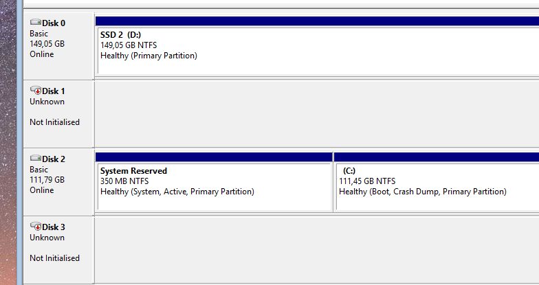

max84 Posted November 23, 2014 Author Share Posted November 23, 2014 I have updated the chipset drivers. When I wake the computer from sleep, and go into the disk management, this is what I see. After a restart everything is back from normal, so the disks do work. It must be a software problem. Link to comment Share on other sites More sharing options...
