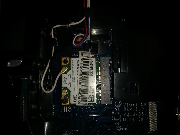

Jose_49 Posted January 1, 2015 Author Share Posted January 1, 2015 So, I haven't done any purchase to be sure that I'm going to buy the right thing. I'll be going this time with the Azurewave, as Aergan suggested. I just wanted to confirm if the one provided, will indeed work. I'm also trying to see if it's possible to have Dual Band (or my laptop does not support it? (I think I need 3 antenna cables, instead of 2)). Not that it's mandatory, but it would be good just in case. I'm attaching a picture of my card. Thanks a lot and Happy New Year Link to comment Share on other sites More sharing options...

Jose_49 Posted January 1, 2015 Author Share Posted January 1, 2015 It's a 2x2 configuration and will require just the two antennas. Dual band relates to supporting 2.4GHz and 5GHz, the antennas are used for Multiple In / Multiple Out (MIMO) to get dual data streams (e.g. 300Mbps rather than 150Mbps over N). Either the Azurewave or the Intel will fit your antenna configuration. Thanks man! :D One more thing, does Azurewave have a Dual Band AC? Link to comment Share on other sites More sharing options...
Aergan Posted January 1, 2015 Share Posted January 1, 2015 Thanks man! :D One more thing, does Azurewave have a Dual Band AC? Yes, mine connects to my AC access point at 5GHz. Jose_49 1 Share Link to comment Share on other sites More sharing options...
