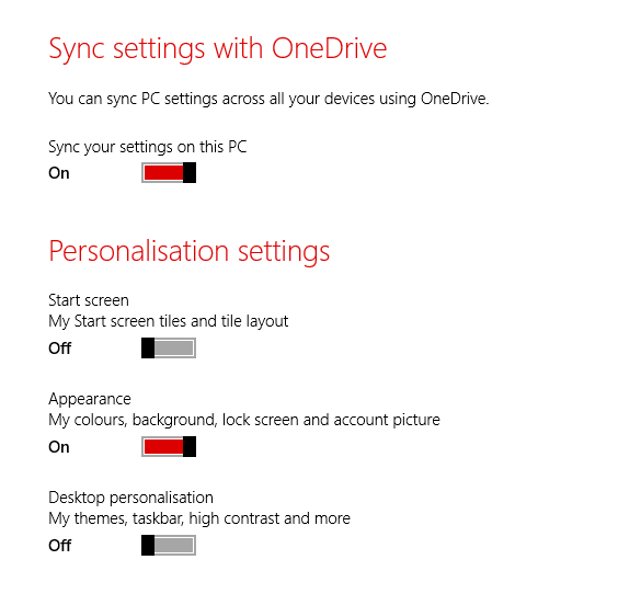

Kuze Posted December 22, 2014 Share Posted December 22, 2014 I'm assuming you're using Windows 8 for this as I don't believe any other windows OS does this due to OneDrive being integrated with Windows to sync settings between PC's. To stop the syncing between the PC's you need to pull up the charms bar, go to settings and then "Change PC Settings" at the bottom. You'll be brought to a new window with options on the left. Go to OneDrive and then Sync settings. Change the Desktop personalisation to off and your theme (or background in your case as nothing else is different) syncing should stop. TruckWEB 1 Share Link to comment Share on other sites More sharing options...
TruckWEB Posted December 22, 2014 Author Share Posted December 22, 2014 Thanks!!! Yeah, Windows 8.1 and I forgot about OneDrive... Working now! Kuze 1 Share Link to comment Share on other sites More sharing options...
