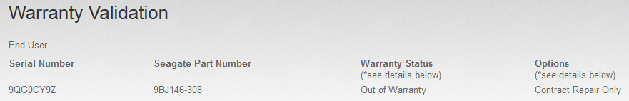

Aergan Posted January 23, 2015 Share Posted January 23, 2015 Sounds like maybe a fault on the logic board for the HDD. Is it under warranty? Link to comment Share on other sites More sharing options...
jnelsoninjax Posted January 23, 2015 Author Share Posted January 23, 2015 Sounds like maybe a fault on the logic board for the HDD. Is it under warranty? No, it's ~ 4 or 5 years old! Like I said in the original post, I have plans to replace these soon! Edit: I just opened HDD sentinel, and saw this on the status of the drive in question: There are 2 weak sectors found on the disk surface. They may be remapped any time in the later use of the disk. At this point, warranty replacement of the disk is not yet possible, only if the health drops further. Problems occurred between the communication of the disk and the host 1002 times. It is recommended to examine the log of the disk regularly. All new problems found will be logged there. No actions needed. The drive found 2 bad sectors during its self test. Link to comment Share on other sites More sharing options...
Aergan Posted January 23, 2015 Share Posted January 23, 2015 No, it's ~ 4 or 5 years old! Like I said in the original post, I have plans to replace these soon! Edit: Yes? Your point? Currently you've neglected to share any specific information about it's manufacturer or model. I have a WD Black that's just coming towards the end of its 5 year warranty mark in a machine. Some HDD's are still from the 5 year warranty "golden age". Link to comment Share on other sites More sharing options...
jnelsoninjax Posted January 24, 2015 Author Share Posted January 24, 2015 Yes? Your point? Currently you've neglected to share any specific information about it's manufacturer or model. I have a WD Black that's just coming towards the end of its 5 year warranty mark in a machine. Some HDD's are still from the 5 year warranty "golden age". Also, seatools says that the drive is fine... Link to comment Share on other sites More sharing options...
