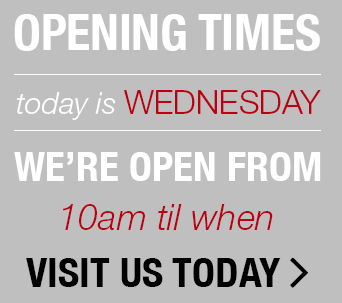

So I'm making a website and in one of the section I want a simple layout as you can see here:
I'm pretty sure I need to use javascript to vary the responses "today is (day)" and "10am til when". The responses are as follows:

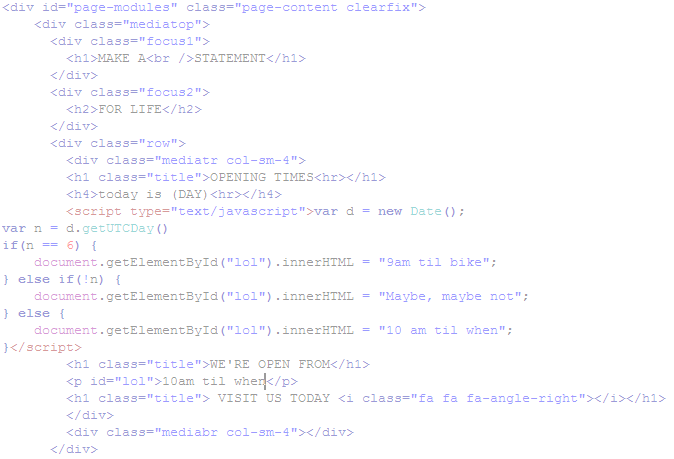

I must be being pretty stupid here guys, but I've included the code and can't get it to display on the page at all. I think I need one bit of code that will say what day it is "Wednesday" or whatever and I need this to just display in a way that I can format it. I then need the second bit of code, which you've provided for me above but I'm not sure what I'm doing wrong...
The image is washed out because dreamweaver is in the middle of crashing (stupid program) and I've added in the text "today is (DAY)" and "10am til when" myself so I could roughly format the rest of that section.
  • 0
  On 27/01/2015 at 18:55, perochan said:
one rule of thumb is
put all script file (js or etc.) or inline js codes after all your HTML codes but before </body> tag.
Or use jquery - $(document).ready(function () { });
