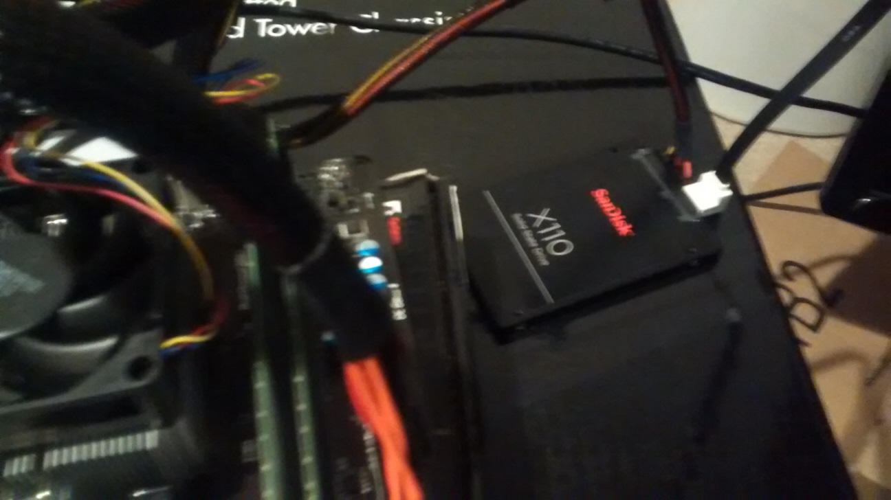

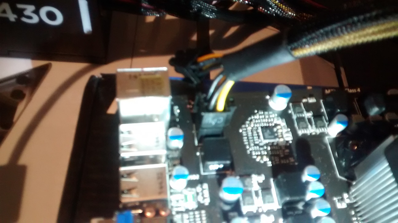

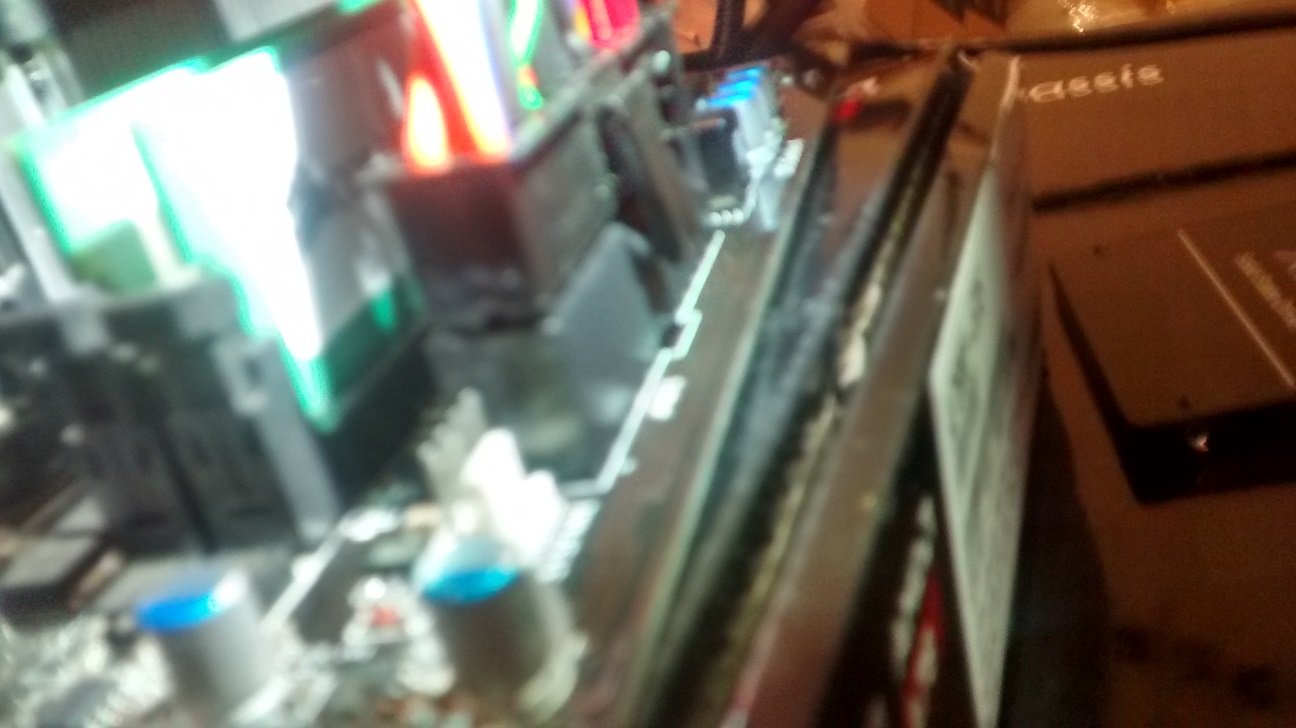

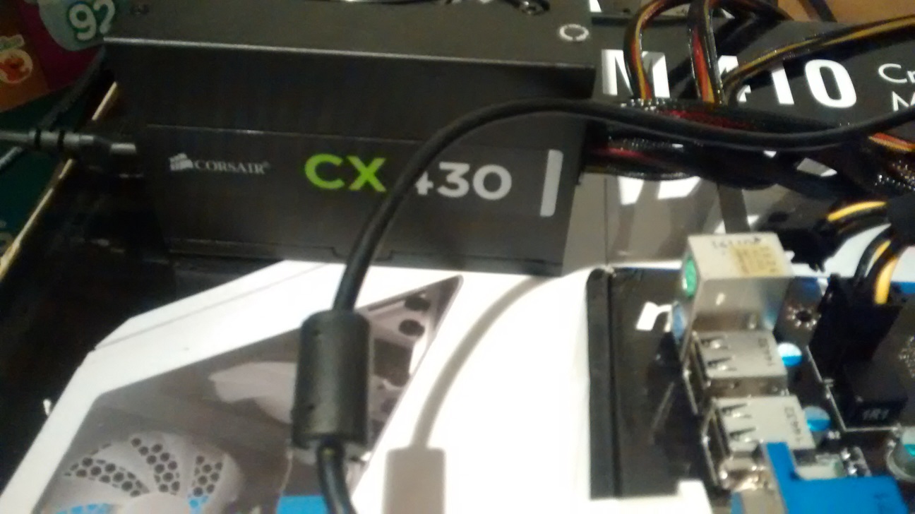

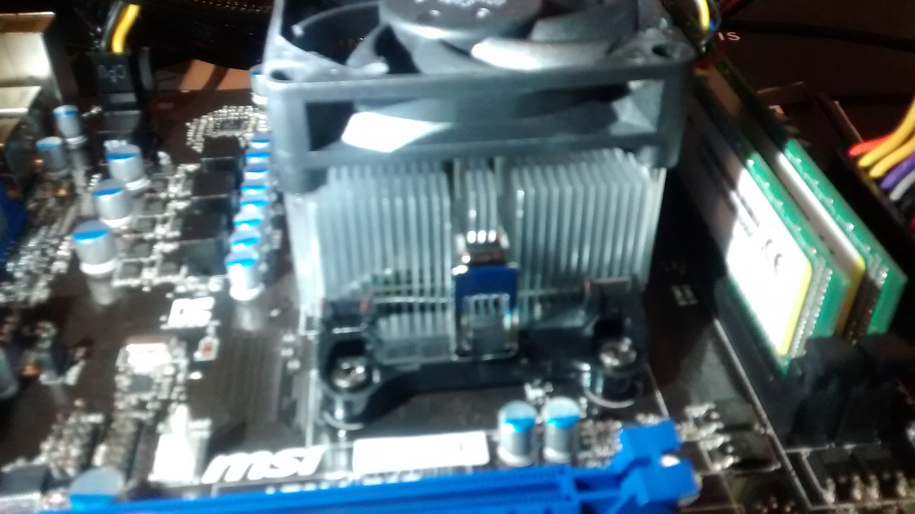

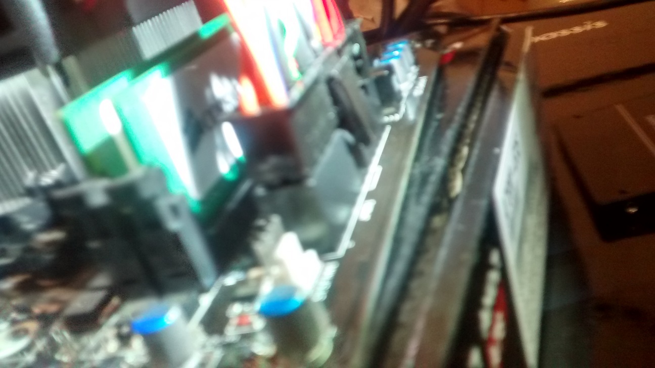

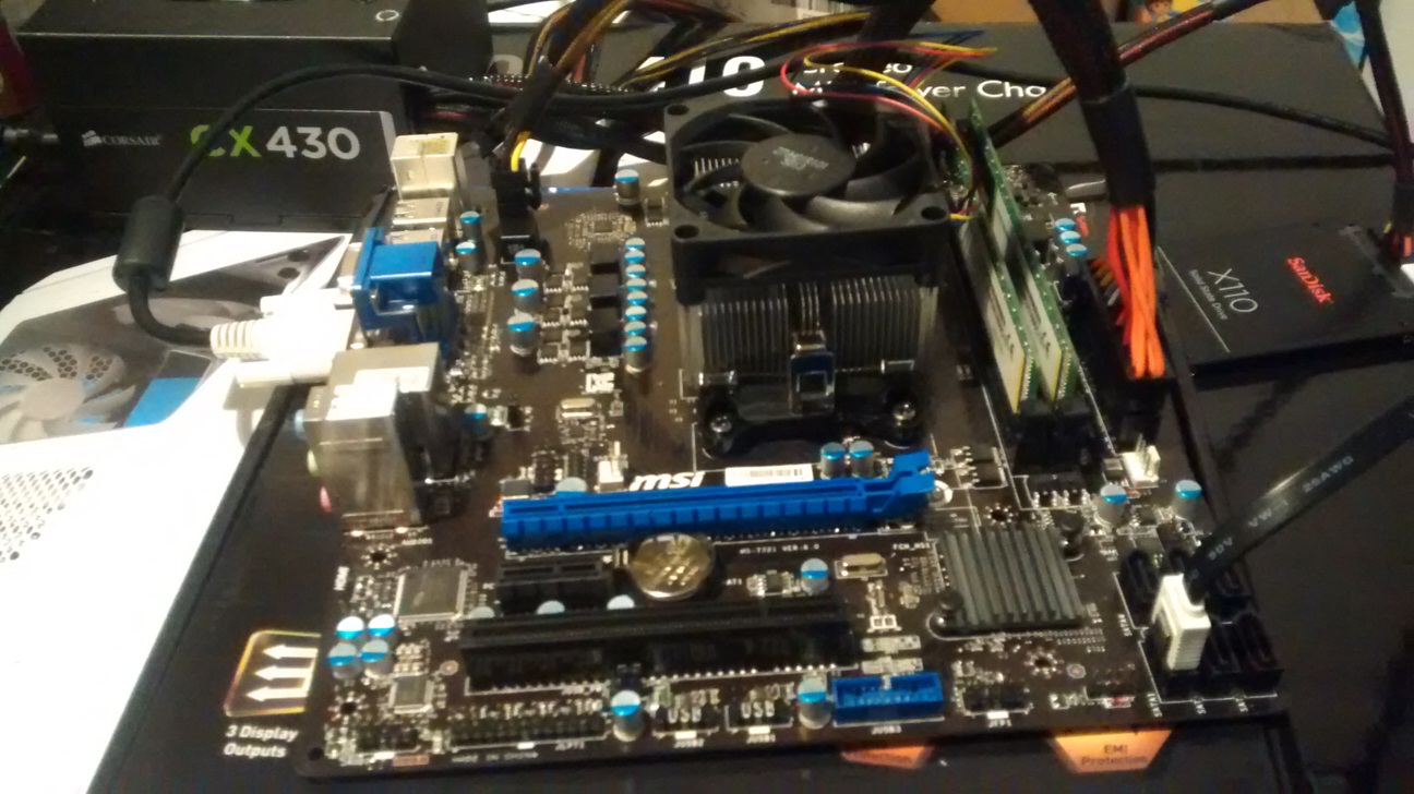

soniqstylz Posted February 3, 2015 Author Share Posted February 3, 2015 Ok, so I pulled everything out of the case in an attempt to start from the basics. Mounted the motherboard on a cardboard box and only plugged in the necessities (RAM, left the CPU as-is, PSU, monitor via VGA, and a 128GB SSD that I'll use for the OS once I can boot everything up). Here are pictures in case anyone has any ideas of what might be wrong to begin with. Now, here comes what might be the stupid question -- how the hell do I power the mobo on outside of the case? Nevermind figured that part out. Here goes. Link to comment Share on other sites More sharing options...
Baz_ Posted February 3, 2015 Share Posted February 3, 2015 Your Multi Plug aint in properly, Also As far as i remember your Mother board needs an earth, hence you have gold motherboard mounts to your Case chassis Link to comment Share on other sites More sharing options...
soniqstylz Posted February 3, 2015 Author Share Posted February 3, 2015 Okay got it to power up and into the BIOS. Fingers crossed it works when I work everything into the case. Your Multi Plug aint in properly, Also As far as i remember your Mother board needs an earth, hence you have gold motherboard mounts to your Case chassis that's as far as I could get it in Link to comment Share on other sites More sharing options...
soniqstylz Posted February 3, 2015 Author Share Posted February 3, 2015 Okay, so I got everything back in the case, rewired the whole thing, and again it won't fire up with the molex fan cord from the PSU plugged into "sysfan" on the motherboard. Outside of that, I think everything works Link to comment Share on other sites More sharing options...
soniqstylz Posted February 3, 2015 Author Share Posted February 3, 2015 Oh holy ###### I'm dumb. So I didn't need to plug the PSU fan cord into the mobo since the case already has a fan controller. Just needed to plug it into the molex and I'm good. Installing Windows now. Thanks for your help everyone! Link to comment Share on other sites More sharing options...
