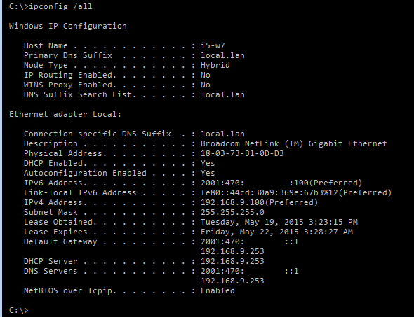

+BudMan MVC Posted May 21, 2015 MVC Share Posted May 21, 2015 so do this same test when you have the problem again, and does it work with IP vs name to the box your trying to rdp too. Just to validate that the tz is not changing and your times are correct, etc. Do you plan on cleaning up the isatap, teredo, 6to4 stuff. I doubt your actually using any ipv6 since all I saw as linklocal - so I would prob just disable it across the board until such time your ready to actually set it up. for sure remove all the BS adapters for teredo and isatap, 6to4.. Simple netsh cmds can get rid of those while still leaving ipv6 intact on your actual interface. Those are all methods of getting to ipv6 when you don't have ipv6 which really not going to work unless you allow it on your firewalls, etc. So just clutters up your ipconfig /all see how clean ipconfig can look - even when using ipv6 Link to comment Share on other sites More sharing options...
