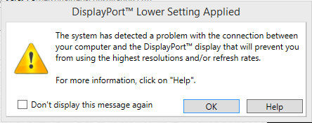

ultimate99 Posted May 27, 2015 Author Share Posted May 27, 2015 This error message comes up as well, sometimes. What's DDU? Link to comment Share on other sites More sharing options...
