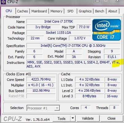

Dumb question ...
Does it show on CPU-Z?
Edit:  what @Clirionsaid. :)  Control Panel > Programs > "Turn Windows features on or off" > Uncheck Hyper-V if checked
