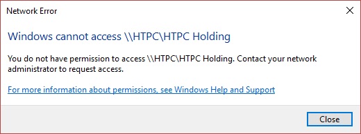

Sir Topham Hatt Posted October 19, 2016 Author Share Posted October 19, 2016 (edited) Both are online but... 1) Why use the internet when I should be able to transfer directly between them both? 2) Some of the files I am storing are rather large 3) Surely, providing it works correctly, it would be way loads quicker to simply navigate to the "Network" of This PC, then choose what files I want and transfer them over? Here's some screenshots: Two folders, permissions exactly the same but I can't access the Holding hard drive from the other PC: Here's the dialog I get when trying to access it: One last thought is that it doesn't matter that my networks are called different things? The HTPC says "network" but the other computer says "network 2". I had another look at HomeGroups just in case that would help bridge the connection between them but the HTPC says I've already created one (not that I can view the password or whatever) and the other PC says it wants to create one. It's strange though as I've just transferred a bunch of files to the folder on the HTPC I can access from the other PC, so I know both can talk to each other... although saying that now, the HTPC can't see the other PC's shared hard drive anymore. Edited October 19, 2016 by Sir Topham Hatt Link to comment Share on other sites More sharing options...
+BudMan MVC Posted October 19, 2016 MVC Share Posted October 19, 2016 those are share permissions, what are the ntfs permission? Mando 1 Share Link to comment Share on other sites More sharing options...

Mando Posted October 19, 2016 Share Posted October 19, 2016 (edited) 6 hours ago, Sir Topham Hatt said: Both are online but... 1) Why use the internet when I should be able to transfer directly between them both? 2) Some of the files I am storing are rather large 3) Surely, providing it works correctly, it would be way loads quicker to simply navigate to the "Network" of This PC, then choose what files I want and transfer them over? Here's some screenshots: Two folders, permissions exactly the same but I can't access the Holding hard drive from the other PC: Here's the dialog I get when trying to access it: One last thought is that it doesn't matter that my networks are called different things? The HTPC says "network" but the other computer says "network 2". I had another look at HomeGroups just in case that would help bridge the connection between them but the HTPC says I've already created one (not that I can view the password or whatever) and the other PC says it wants to create one. It's strange though as I've just transferred a bunch of files to the folder on the HTPC I can access from the other PC, so I know both can talk to each other... although saying that now, the HTPC can't see the other PC's shared hard drive anymore. Win 10 and 2k12 + have all sorts of issues without a pwd for share access. set a password on both accounts, force autologin then use the format \\PCA\account name & password on the share \\PCB\share once you set and tell it to use alternative creds, it will work forevermore. also check your NTFS ACL matches the share permissions. Also ensure they are in the same "workgroup" share$ ACL and NTFS ACLS are two different access methods and both need looked at. its lack of password it has an issue with. Link to comment Share on other sites More sharing options...
