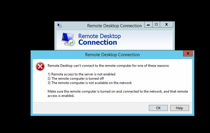

I have a Windows Server 2012 r2 Essentials box that is running AD, remote web access, and application server. I have about 15 machines joined. I am only trying to connect to the built in administrator RDP session. I am not running Remote Desktop Services other than what is required to use RWW. All my firewall points are open. Forwarded TCP/UDP to port 3389 to it, and made sure Windows Firewall had the correct rules. I have ESET File Security running also.
I am unable to connect. Not even from RWW.
Please help.

Yes. I tried connecting by IP. Same error I get when using HOSTNAME.
Quote
Remote Desktop Cant connect to the remote computer for one of these reasons:
1) Remote access to the server is not enabled
2) The remote computer is turned off
3) The remote computer is not available on the network
Make sure the remote computer is turned on and connected to the network, and that remote access is enabled

No, not locally. I am only trying to connect locally before attempting to connect remotely. I dropped the Firewall and all AV. Still no joy.

Cant connect locally. Tried IP and HOSTNAME
Remote access is checked in the system properties. Administrator has automatic access

ip is static and has not changed. I am just trying to connect locally. THIS IS CRAZY!!!!!
sc302 is my hero of the day.
I changed the listening port in the past.. and when I changed it back to 3389, I entered it into the wrong box in the regedit editor..
Just went down for a reboot.. lets see. Thanks so much again sc302
RDP IS NOT HOSED ANYMORE
