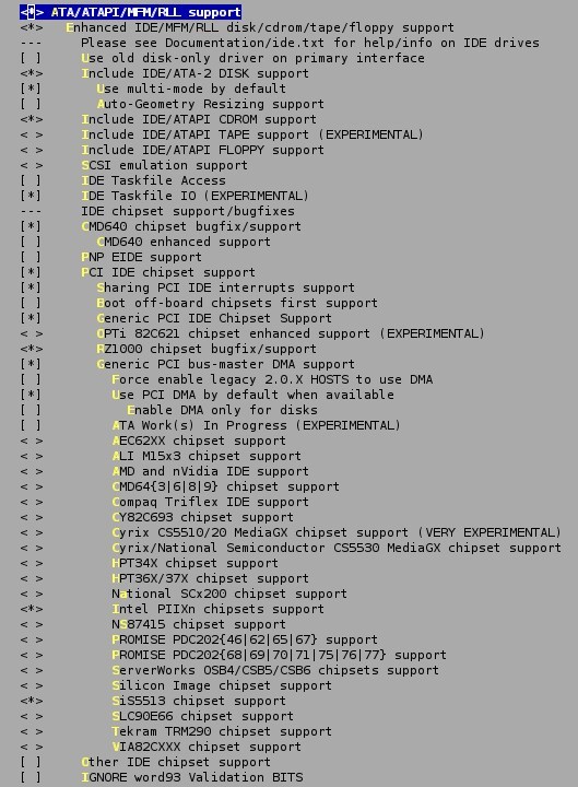

Tran Posted January 24, 2004 Author Share Posted January 24, 2004 OK I did what you guys told me but it still doesn't work. Here the two screenshots of what has been ticked and not been ticked in the "menuconfig". Screenshot #1: Link to comment Share on other sites More sharing options...

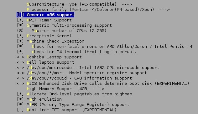

Tran Posted January 24, 2004 Author Share Posted January 24, 2004 And here's screenshot #2: Link to comment Share on other sites More sharing options...
MrStaticVoid Posted January 24, 2004 Share Posted January 24, 2004 ...and what is your exact motherboard chipset? Your second screenshot looks almost exactly like mine. Immediately after you boot your comp, run "dmesg > ~/dmesg.txt" and attach ~/dmesg.txt to your next post. That will help a lot. Link to comment Share on other sites More sharing options...
