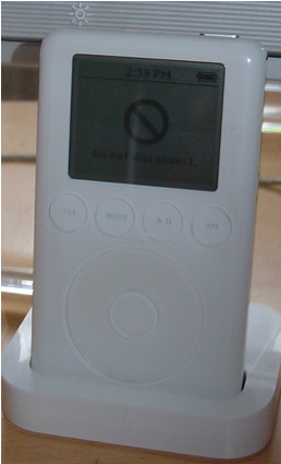

Steve Posted February 1, 2004 Share Posted February 1, 2004 I leave it sat like this, unless i am using it. Link to comment Share on other sites More sharing options...
nummi Posted February 1, 2004 Share Posted February 1, 2004 I leave it sat like this, unless i am using it. NOOOO!!! Don't leave it mounted on your desktop! The hard drive will keep spinning while mounted, and shorten the life of your iPod. Link to comment Share on other sites More sharing options...

Steve Posted February 1, 2004 Share Posted February 1, 2004 NOOOO!!! Don't leave it mounted on your desktop! The hard drive will keep spinning while mounted, and shorten the life of your iPod. Does it really? :o Thats me buggered then, i've done it since April! :p But will the disc really spin, when i'm not actually interacting with it? I can't see why it would, its always mounted, but I rarely use it. Link to comment Share on other sites More sharing options...

Si Veteran Posted February 1, 2004 Veteran Share Posted February 1, 2004 Does it really? :o Thats me buggered then, i've done it since April! :p But will the disc really spin, when i'm not actually interacting with it? I can't see why it would, its always mounted, but I rarely use it. Just go into itunes and eject it from there. It's only spinning when the do not disconnect icon is on the screen. Link to comment Share on other sites More sharing options...
Max Veteran Posted February 1, 2004 Veteran Share Posted February 1, 2004 Does it really? :o Thats me buggered then, i've done it since April! :p But will the disc really spin, when i'm not actually interacting with it? I can't see why it would, its always mounted, but I rarely use it. I've just read this. Q: Is it okay to leave the iPod in the dock, or otherwise attached to external power, for extended periods of time? A1: Yes. The iPod's circuitry will no longer charge the battery once it is determined to be full, even if the iPod is still attached to external power. So no battery problems there, just the hard drive. Link to comment Share on other sites More sharing options...

Steve Posted February 1, 2004 Share Posted February 1, 2004 I've just read this.So no battery problems there, just the hard drive. OK, thanks for the heads up. The Hard Disc is will still probably outlast the 'supposed' life of the battery, so I think I am safe. But just to be safe, i'll turn off FireWire Disc access.... :unsure: Cheers Link to comment Share on other sites More sharing options...

ad345zAdZ0d9_ Posted February 3, 2004 Share Posted February 3, 2004 NOOOO!!! Don't leave it mounted on your desktop! The hard drive will keep spinning while mounted, and shorten the life of your iPod. Not really, it spins up once, but spins down again after a few seconds. Mine never keeps spinning, and if yours does, you should ring apple Link to comment Share on other sites More sharing options...
