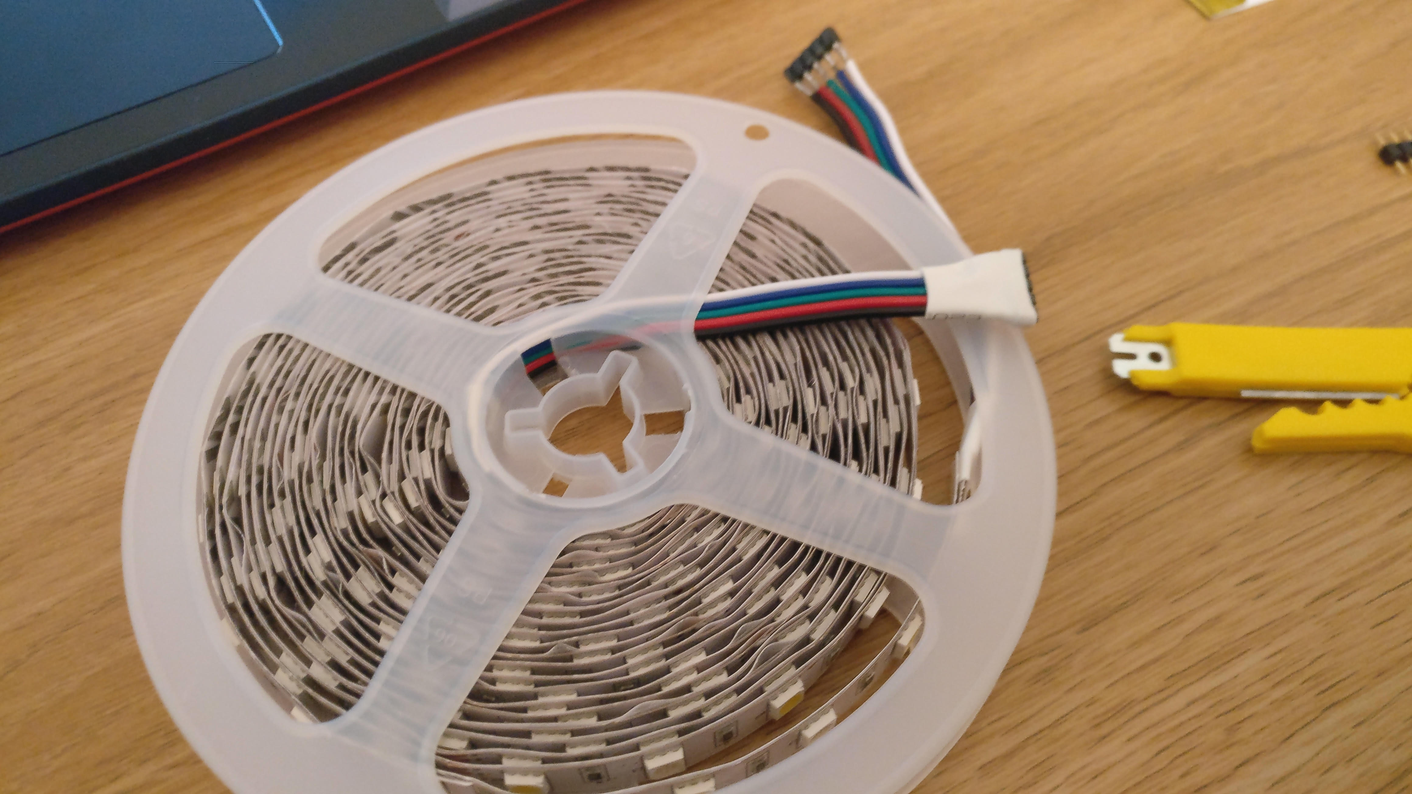

  • LED Lightstrip - $6.40 I  went with RGB with warm white because I wanted to be able to use it without all the colours too. This for a 5m roll

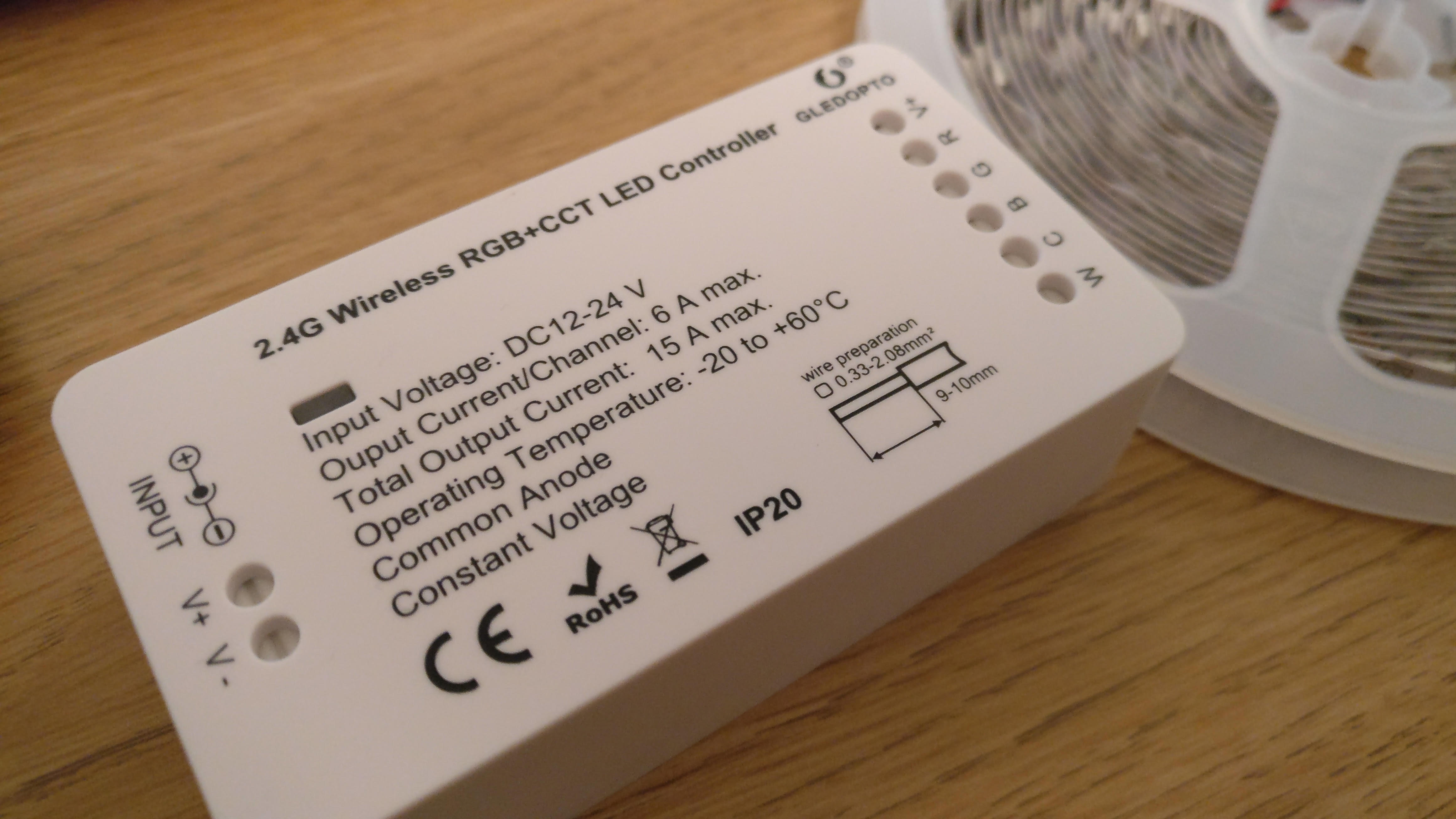

  • Zigbee Controller - $21 The most expensive bit of the setup but it has all the brain

Controller was a little white box about the size of a credit card albeit a little thicker.
And the LEDs. When you buy, there are a few options (backing colour etc). I went with a non-waterproof version, because it wasn't something that I thought was needed. I found that the non-waterproof lacked the plastic coating that you find with the Philips Hue strips, which makes these a little less 'finished' If buy more in the future, I'll go for the IP65 ones.
Now the fun part. The LED strip is nicely finished at either end, which I stripped and inserted into the appropriate insert on the controller. Took all of about 5/6 minutes.
Searched for the new light in the Hue app and presto. All working, I've got a video below.
