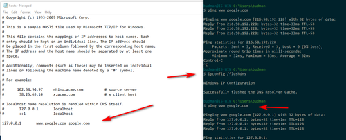

You need to ipconfig /flushdns
make sure your hosts file hasn't been saved as hosts.txt by mistake as well
  • Thanks 1
Who does this anymore?  Run pihole if your looking to block ###### ;)  Or block it on your dns directly with a host override?
Do a simple ping does it come back as 127.0.0.1?
Also if your browser is using a proxy, doesn't matter what you put in your host file since proxy is what resolves, not the local client.
But to your use of host file... Here how to test your setting is working... Keep in mind that hosts file will need admin rights to manipulate... Its also possible your running some antivirus software that prevents manipulation of the hosts file.. And yeah sagum is right, many users will save it has hosts.txt which never used.

You need to make sure that you have entered the fully-qualified domain name (FQDN) into the hosts file.  For example, if you wanted to block https://www.example.com/ you would want to enter the following lines into the hosts file:
127.0.0.1 example.com
127.0.0.1 www.example.com
Note that you do not enter the protocol handler (https, http, ftp, et cetera), just the applicable hostnames.

Thanks, I figured it out, and successfully blocked a site as a test using 0.0.0.0 instead of the 127.0.0.1

There are a bajillion things that could of been reason.
Didn't put entries in file correctly
saved the file with ext like .txt
didn't put in the actual fqdn of what the client was using for whatever site trying to block
didn't flush the clients local cache, or even the browsers cache - both of which are different caches
browser was using a proxy (dns and or even local host file not used then)
etc. etc. etc..
